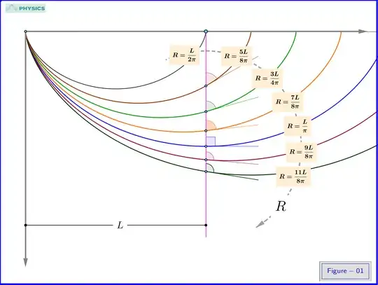

Then think of a $\,R-$parametric family of cycloids intersecting the vertical line with $\theta(R)$. The time for the $\,R-$cycloid would be \begin{equation} t(R)=\sqrt{\dfrac{\,R\,}{g}}\, \theta(R) \tag{04}\label{04} \end{equation} and for the minimum $\,t(R)\,$ find the roots of \begin{equation} \dfrac{\mathrm d t(R)}{\mathrm d R}=0 \tag{05}\label{05} \end{equation} The angle $\theta(R)$ is the following implicit function of $\,R$(1) \begin{equation} \theta(R)-\sin\left[\theta(R)\right]=L/R \tag{06}\label{06} \end{equation} where $\,L\,$ the horizontal distance of the vertical line from point $\texttt P$.
We must remind that the slope $\,\mathrm d y(\theta)/\mathrm d x(\theta)\,$ on a cycloid and the angle $\,\theta\,$ are related as follows \begin{equation} \dfrac{\mathrm d y}{\mathrm d x}=\dfrac{\sin\theta}{1-\cos\theta}=\cot\left(\dfrac{\theta}{2}\right) \tag{07}\label{07} \end{equation}

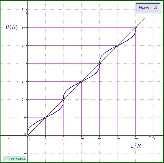

(1) The angle $\,\theta(L/R)\,$ as function of the dimensionless variable $\,L/R\,$ would have a graph like that in Figure-02 below. Note that for $\,L/R=k\pi\,(k=1,2,3\cdots)\,$ we have $\,\theta\left(L/R\right)=k\pi\,$ while the graph is repeat of a segment of width $\,2\pi$ : $\,\theta\left(L/R+2\pi\right)=\theta\left(L/R\right)+2\pi\,$. enter image description here
