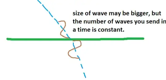

Think of it like this: At the boundary/interface of the medium, the number of waves you send is the number of waves you receive, at the other side, almost instantly. Frequency doesn't change because it depends on travelling of waves across the interface.
But speed and wavelength change as the material on the other side may be different, so now it might have a longer/shorter size of wave and so the number of waves per unit time changes.
