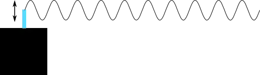

It is best to first simplify the situation and think about why is the frequency of the wave the same as the source.
Considering the case of a string attached to an oscillator, if the frequency of the oscillator and the wave were different, there would need to be a discontinuity in the string. The fact that the string is attached to the oscillator means they need to oscillate at the same frequency.
Now, in your case you describe a situation where the same source is attached to two different mediums. This is analogous to an oscillator attached to two strings of different thickness. As shown, the frequency must be the same. The speed of propagation depends on the medium. In the case of a string it will be $$ v = \sqrt{\frac{\text{tension}}{\text{mass per unit length}}}. $$ Then, the wavelength must change accordingly to keep the $v/\lambda$ ratio constant.
