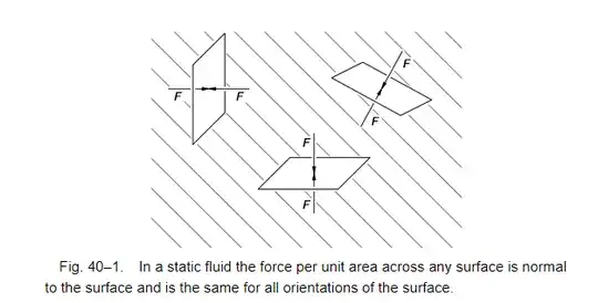

In the Flow of dry water chapter of Feynman lecture, this following point is written (see here):
The law of hydrostatics, therefore, is that the stresses are always normal to any surface inside the fluid. The normal force per unit area is called pressure. From the fact that there is no shear in a static fluid, it follows that the pressure stress is the same in all directions (Fig. 40-1). We will let you entertain yourself by proving that if there is no shear on any plane in a fluid, the pressure must be the same in any direction.

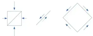

The fact that different principal stresses leads to shear can be visualized in the picture below. The max and min. principal stresses are shown. Suppose there is a weak plane at the diagonal of the cube. It is clear the potential direction of displacement, corresponding to the shear components of the loading.
As showed in the Dale's answer, for an angle of $45^{\circ}$ there is a maximum of the shear stresses, that are proportional to the difference between the principal stresses.
The only way to avoid shear stresses is if all principal normal stresses are equal. In this case the projections at $45^{\circ}$ cancel.

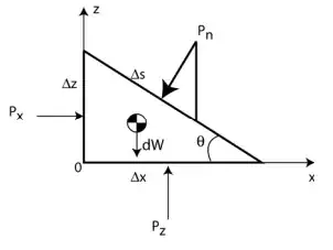

A triangular volume element with arbitrary n note that width is y
So lets start here:
Remember that there is no shear stress for a fluid with no force fields. So we get $$p_xw\Delta z-p_nb\Delta s \sin(\theta)=0$$ $$p_zb\Delta x -p_nb\Delta s \cos(\theta)-\rho b (\frac{1}{2} \Delta x \Delta z)=0$$
Now using $\Delta z=\Delta s \sin(\theta)$ and viz. And setting $\Delta x \to 0 $ $\Delta z \to 0$ which gives us our isotropic condition $$p_x=p_y=p_n$$ Note that $\hat n(\theta)$ is arbitrary. Now say a net force acts in z direction to a cubical element(gravity). Let's assume a pressure $p_0$ acts in upward direction at the bottom of the element $$p_{top}=p_0+\frac{d p}{dz} \Delta z$$ Now force acting on the element in z direction is $$F=-\frac{dp}{dz}dxdydz$$ Now force due to its weight is $$F_{weight}=-\rho g dxdydz$$ Condition for static equilibrium gives $$\frac{dp}{dz}=-\rho g$$
