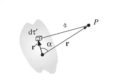

I'd really like to have an analogous list for the electric charge $q$. Now, the $0^{\rm th}$ moment is obviously the total electric charge: $$Q = \int \rho({\bf r}) \space d\tau $$ As $1^{\rm st} $ moment the only example I can mention is the dipole moment: $$ {\bf p} = \int {\bf r} \space \rho({\bf r}) \space d\tau $$ but I can't give it a meaningful interpretation... Is it the position vector for the "centre of charge"? Well no, I think. In the simple case of a dipole, with +q and -q separated by a distance ${\bf d}$ going from -q to +q, this so-called 'centre of charge' should be zero and placed in between the two (using simmetry arguments), while ${\bf p} = \rm q \bf d $, clearly not zero. So how should I think of it?
For the $2^{\rm nd}$ moment I have no clues... Is it even reasonable to have an equivalent "moment of inertia" for electric charge? Actually (see Griffiths), there is a general expression involving all the moments, it's called multipole expansion of the potential $V$ in powers of $1 \over r$ (Legendre Polynomials). Namely, $$V({\bf r}) = {1\over 4\pi\epsilon_0} \sum_{n=0}^{\infty} {1\over r^{n+1}} \int (r')^n \space {\rm P}_n({\rm cos \space \!}\alpha) \space \rho({\bf r}') \space d\tau' $$

So, what are we to do? The answer comes from understanding where the approximation $(2)$ comes from. In short, the full potential is known to be of the form $$ V(\mathbf r) = \frac{1}{4\pi\epsilon_0} \int \frac{\rho(\mathbf r')}{|\mathbf r-\mathbf r'|}\mathrm d\mathbf r', \tag 3 $$ and the approximation $(2)$ comes from a Taylor expansion of the Coulomb kernel, $\frac{1}{|\mathbf r-\mathbf r'|}$, in powers of $(\mathbf r' - \mathbf r_0)/|\mathbf r-\mathbf r_0|$ (where $\mathbf r_0$ is an arbitrarily-chosen origin, and $\mathbf r$ should be "outside" the charge distribution, i.e., further away from $\mathbf r_0$ than any of the $\mathbf r'$). As it turns out, the first couple of terms of this expansion are reasonably simple to work out: $$ \frac{1}{|\mathbf r-\mathbf r'|} = \frac{1}{|\mathbf r-\mathbf r_0|} + \frac{(\mathbf r-\mathbf r_0)\cdot (\mathbf r'-\mathbf r_0)}{|\mathbf r-\mathbf r_0|^3} + \mathcal O\mathopen{}\left(\frac{|\mathbf r'-\mathbf r_0|^2}{|\mathbf r-\mathbf r_0|^3}\right)\mathclose{}. \tag 4 $$ If you then plug this $(4)$ back into $(3)$, you basically get back $(2)$, with an additional correction: $$ V(\mathbf r) \approx \frac{Q}{4\pi\epsilon_0} \frac{1}{|\mathbf r-\mathbf r_0|} + \frac{1}{4\pi\epsilon_0} \frac{\mathbf r-\mathbf r_0}{|\mathbf r-\mathbf r_0|^3} \cdot \int(\mathbf r'-\mathbf r_0)\rho(\mathbf r')\mathrm d\mathbf r'. \tag{5} $$ The coefficient in that last term, $$ \mathbf d = \int(\mathbf r'-\mathbf r_0)\rho(\mathbf r')\mathrm d\mathbf r', \tag 6 $$ is the dipole moment (relative to the origin $\mathbf r_0$), so we can reexpress $(5)$ in a cleaner form: $$ V(\mathbf r) \approx \frac{Q}{4\pi\epsilon_0} \frac{1}{|\mathbf r-\mathbf r_0|} + \frac{1}{4\pi\epsilon_0} \mathbf d\cdot \frac{\mathbf r-\mathbf r_0}{|\mathbf r-\mathbf r_0|^3}. \tag{7} $$
