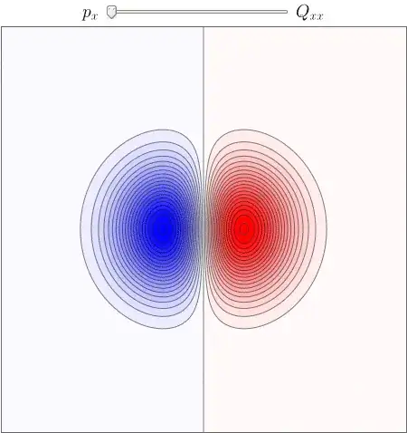

As to how this looks, here are some plots of our counterexample $\rho(\mathbf r)$ as the parameters go from purely dipolar to purely quadrupolar and back:
None of the displayed distributions (with the exception of the extremes) can be brought to dipole + hexadecapole form via a translation. The image link should lead to an interactive version of this animation, but it's rather sluggish so give it some time.
