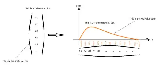

Remember that - because our observables correspond to Hermitian operators acting on the Hilbert space, $\mathcal H$, containing the state vectors, $|\psi\rangle$ - the set of all eigenvectors of each operator can be used as a basis for $\mathcal H$. This includes (brushing a few things under the carpet) the position operator, $\hat x$.
Now imagine you are given a state, $|\psi\rangle$. If we change the basis for $\mathcal H$ to the one generated by the position eigenvectors, the components of $|\psi\rangle$ can be written $\langle x|\psi\rangle=\psi(x)$. So for a given value of $x$, $\psi(x)$ represents one particular component of the state vector $|\psi\rangle$. We essentially parameterise the components of $|\psi\rangle$ by $x$ and this produces a function of $x$.
There are some technical issues we are avoiding here, quantum mechanics is complicated. A more mathematical statement of what I've just written would be to say that $\mathcal H$ (which contains the $|\psi\rangle$'s) is isomorphic as a Hilbert space to the space of square integrable functions on an interval (which contains the $\psi(x)$'s): $$\mathcal H\cong L^2(\Bbb R). \tag{1}$$
Edit: Maybe this (crudely drawn) diagram helps explain roughly what we're doing here (it is not rigorous, only intended to help visualise it):
