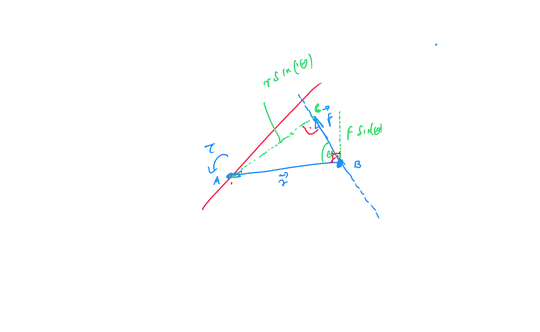

We want to obtain the torque $~\tau~$about point A .If you look at the figure :
Case I
find at point B the component of the force $\vec{F}$ that is perpendicular to $\vec{r}$ which is $F\,\sin(\theta)$ thus
$$\tau_A=F\,\sin(\theta)\,r$$
Case II
find at point C the component of the force $\vec{r}$ that is perpendicular to $\vec{F}$ which is $r\,\sin(\theta)$ thus
$$\tau_A=r\,\sin(\theta)\,F$$
I agree with you that case I is more "intuitive" to obtain the torque $\tau_A$ then case II.
