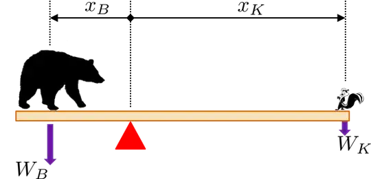

The relevance of a property related to multiplying the force by the lever arm comes from the experience with one of the oldest tools of mankind: the lever.
In this answer to a similar question I approached this with statics, by introducing the concept of "balance".
post
To quantify the idea of "balance" you need a description of the weight of each object as well as how far away does this weight applies relative to the fulcrum (red triangle).
You equate the moments
$$ \text{(moment of bear)}=\text{(moment of skunk)} $$ $$ x_B\; W_B = x_K\; W_K $$
where xB and xK are the distances (of the bear and the skunk respectively), and WB and WK the weights (of the bear and the skunk respectively).

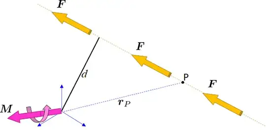

But to really answer this question, on a bit more fundamental level, I want to introduce the concept of line of action of a force.
Torque is just a special case of a moment. Specifically the moment of a force. In the diagram below you see the same force (vector) $F$ acting along some line in space that is offset from the coordinate system we use.
fig
The moment of the force as seen felt by an observer at the coordinate origin does not change when you slide the force vector along its line of action. The effect is the same. This effect has the quality of twisting (light pink curved arrow) and the further away the force is, and the stronger the force is the stronger this twisting.
Mathematically this twisting is described by the moment vector (darker pink arrow) and it is defined as the cross product between the position vector $\boldsymbol{r}_P$ and the force vector $\boldsymbol{F}$
$$ \boldsymbol{M} = \boldsymbol{r}_P \times \boldsymbol{F}$$
The cross product is a special multiplication operation that filters out any components parallel between the two vectors. The result in magnitudes is
$$ \| \boldsymbol{M} \| = d \; \|\boldsymbol{F}\| $$
where $d$ is the perpendicular distance to the line of action of the force. The quantity $d$ is purely geometrical in nature.
The moment of a force is a quantity that describes how far away a force is acting from the coordinate origin, as in $d = \| \boldsymbol{M} \| / \| \boldsymbol{F} \|$
Summary
  • We use the perpendicular distance for torque (moment of force) because force vectors can be moved freely along their line of action.
  • We use the cross product the evaluate moments exactly because they ignore parallel components and only consider the perpendicular distances.
You can go a level deeper by reading this answer and understand that the above applies not only to the moment of forces $M = r \times F$, but also the angular momentum (moment of momentum) $L = r \times p$ and even velocity (moment of rotation) $v = r \times \omega$.
All three situations above are examples of situations where an action is performed along a line in space that is offset from the origin. This line might be called the line of action, or the percussion axis, or the rotation axis, but the underlying geometry of this situation is the same.
