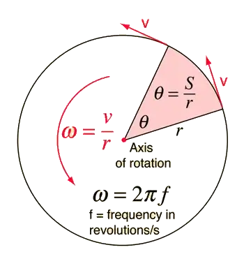

I think it might help to consider a case of uniform circular motion. The OP is already aware about its general derivation through differentiation, but uniform circular motion may help develop some intuition.
Consider that an object undergoes circular motion with constant angular velocity $\omega$ and thus constant speed $v$. A complete angle is $2 \pi$, so we may state:
$$\omega = \frac{2 \pi}{T} \ \ \ \ (1)$$
where $T$ is the time period for one revolution.
Circumference of circle is $2 \pi R$, so speed may be represented as: $$v= \frac{2 \pi R}{T} \ \ \ \ (2)$$ Substituting $(2)$ in $(1)$, we get $$\omega = \frac{v}{R}$$
Now that we have derived this equation, we notice that while $\omega$ tells us about the rate at which angle is covered in radians, multiplying it by $R$ leads us to the rate at which the circumference is traced.
image showing uniform circular motion and basic formulae
