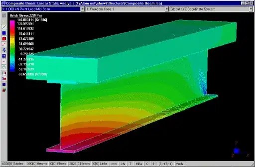

Overall tension is a body reaction force to some stimulating force (weight,pulling,external, etc) and is a specific case of a more general body stress vector field, like :

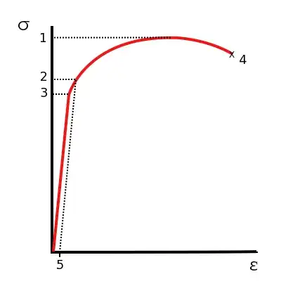

And yes, tension increases proportionally to the force applied. Materials break when pressure applied to them exceeds/reaches ultimate tensile strength, measured in $\text{Pa}$ :
In above stress–strain graph it's an extreme point (1).

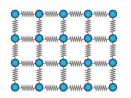

You can visualise the internal structure as this
When you try to elongate , the intermolecular forces respond accordingly but you know that even springs get deformed when you apply greater force and exactly in this way , the intermolecular attractions couldn't rise accordingly and things ( for your case , strings) break .

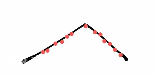

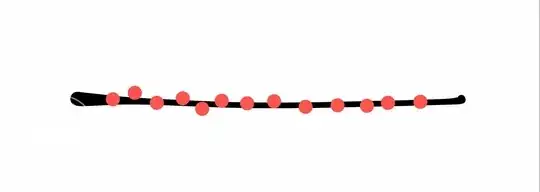

5 : When you bend paperclips , the atoms are being separated from the point you are bending the clip . How do I know this ?
You might have noticed that by multiple bending , first of all the end becomes dull in colour than other parts of the clip and if you continue doing that , it eventually breaks. The dullness in colour is what suggesting that the atoms are being separated and there are lesser atoms to re - emit photons. When you unfold the clip , the atoms couldn't rearrange in the same earlier pattern and in this way the clip starts weakening. In case of ropes , it doesn't happen because the atoms in the ropes regain their original position and we barely notice any elongation or dullness and this property of regaining the original structure depends on the nature of atoms and the extent of intermolecular forces.
Consider the images below
Note : the image of the intermolecular structure is taken from here. The above two images are highly exaggerated and the atoms are in much close vicinity of each other.
