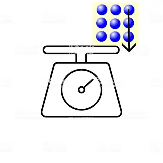

Assume that I'm pushing a box against the table with a force of $80\ \mathrm N$, in accordance to Newton's 3rd Law, it'll exert a force equal but opposite to the box. This is fairly simple to understand.
Now, here's the confusing part, assume, that somehow I could exert the $80\ \mathrm N$ just to that single upper most molecule of the box. {Neglect the possibilities that it'll penetrate to the box or any such.}
If that was the case, how does the box actually "exert" a force on the table or rather How does the force of my hand exert a force on the table via the box?

Possibility 1A
In this case the force exerted on that molecule "pushes" the molecule below it and so on, until the very last molecule of the box "pushes" the table's molecule and thus exerting a force on it. The diagram above gives a pretty clear idea of my assumption.
But, if this was the case then this would happen: enter image description here If I'm going to push that object on that particular point, where that section of molecules of the box isn't "directly" in contact with the surface of the weighting scale, then it won't "read" my pushing force, which obviously doesn't make any sense, and I've tried this experiment a few days back and clearly the scale reads it.

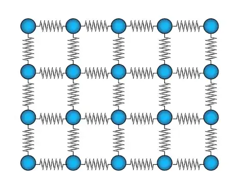

The box is a solid. Solids are not only arrangements of atoms floating toghether, they are related by forces. These forces (which as explained by Hotlab are electromagnetic in nature) act just like the forces on a spring.
In our simplistic model, you should imagine each atom to be connected by springs to the neighbours (the details are much more complex). If one atom gets away from its neighbours then the spring pulls them back, if it gets too close then the spring pushes the atoms away to a more relaxed state.
So for the sake of clarity we are going to assume that our model consists of a rectangular grid of identical atoms connected by springs to their upper, lower, left and right atoms each and only. No atom is connected to the atom in the lower left for example and no atom is connected to more than those 4 atoms. Simply said, each atom is connected with springs to the atoms of its von Neumann neighborhood, like in this image:

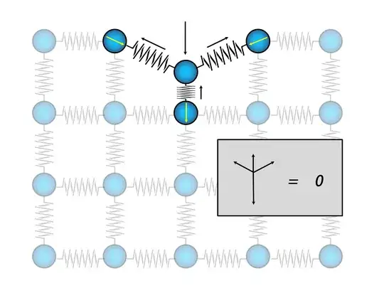

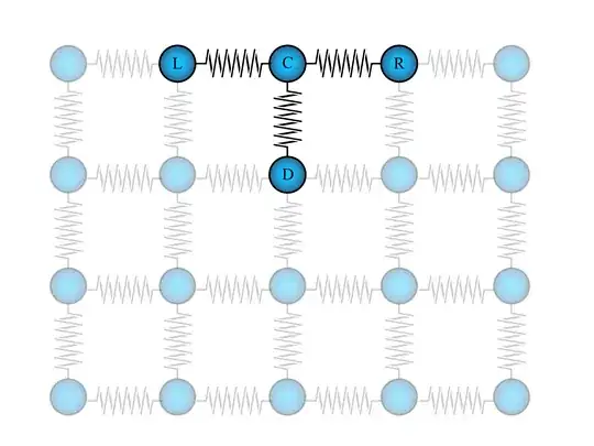

Let's name the atom that you are going to push $C$ (for "central") and let's call its neighbour to the left $L$, the one to the right $R$ and the atom below it $D$ (for down). And let's ignore for a moment the rest of the ensamble.
So, think about it. Right now nothing is moving, everything is in equilibrium, all the springs are in their relaxed state (neither expanded nor contracted). Now you start to push $C$ downwards. As you push $C$ it starts to move downwards (because according to Newton's II Law of motion that force has to generate an acceleration). As $C$ moves down it starts to compress the $C-D$ string and thus a force on the spring starts to arise that wants to expand it, this force is resisting more and more of your downward initial force so that $C$ starts to slow down (as your force on it is counteracted more and more by the string's need to expand). Meanwhile as the $C$ atom was going down, the $C-L$ and $C-R$ are being expanded and thus a force arises also on them, the difference now is that those forces want to contract both the springs (since they are larger than their relaxed length). This string $C-L$ pulls on $C$ to the left and upwards and the string $C-R$ pulls to the right and upwards.
So we have 4 forces acting on $C$ right now: your push from above, the upwards reaction of the $C-D$ string, the left-upwards reaction of the $C-L$ string and the right-upwards reaction of the $C-R$ string. As $C$ continues to move, all these forces are going to change (except for your constant push from above), until it reaches a state of equilibrium where all the spring reactions are as strong as needed to stop you from continuing moving $C$; they reach a point where they exactly counteract your force pushing on $C$. You can tell that this makes sense if you watch this diagram:
I've colored in black the arrows representing the forces acting on the atom $C$. As you can see the net force equals zero, at this moment $C$ stops moving and the system reaches equilibrium (your force is counteracted by the others). You can see that there is a component of the force of the $C-R$ string to the right and the one of the $C-L$ string to the left, since the system is horizontally mirror-symmetric with respect to $C$. This means that the net force has no horizontal components, and $C-R$ is pulling to the right exactly as hard as $C-L$ is pulling to the left. What about the vertical component of the net force? As you can see, all the three reactions of the springs go upwards, so they sum up to the same value you are pushing downwards. I'm not going to calculate exactly how they sum, but clearly (because of the same symmetry argument) the upward contribution of $C-L$ is the same as the upward contribution of $C-R$, together with the upward contribution of $C-D$ string they can oppose perfect resistance to your downward push.
But the system would not remain in this state for long. This would be the end if $R$, $L$ and $D$ were fixed (nailed to the background). But hey are free, thus they are going to move accordingly to the forces they also experience. These forces experienced by the neighbouring atoms I've color coded with yellow and are depicted as arrows inside their corresponding atom. Those forces are exerted by the springs as they want to expand (in the case of $C-D$) or contract (in the case of $C-L$ and $C-R$).

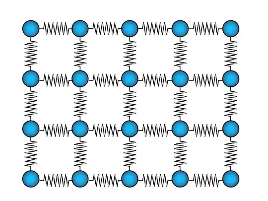

The thing is that these atoms are not fixed but they are free to move. So under these forces (the yellow arrows) they are going to start to move from their original positions. Now is not just $C$ that has moved and thus expanded or contracted 3 neighbouring springs, now we have 3 atoms moving and 9 springs exerting forces in response. I'm just not going to draw all of that. Also in the next step there are going to be 6 atoms relocating and 16 springs exerting different forces. As you can see the evolution of this system explodes in terms of complexity. This means that the task of calculating each force and the new positions on each step gets larger and larger, and it is just crazy to ask someone to accomplish it. These are only 20 atoms but real solids have trillions of them, they are not always so ordered as in this lattice either, they are 3D instead of 2D, the actual electromagnetic forces involved are not acting strictly like springs but a bit differently, there could be different types of atoms and molecules with different string strengths (the chemical bonds) across the solid, the von Neumann neighbourhood could be a simplistic approximation since atoms could be linked to their second most distant neighbours or diagonally, ... But in principle this model should be quite accurate in macroscopic terms.
In physics, when we reach a point where there's an explosion (a unchained increase) in the number of calculations needed to be accomplished to understand the phenomenon (when even simulating it in a computer would take billions of years for a real solid) we tend to avoid this kind of microscopic interactions view and start pondering what the overall behaviour looks like at the macroscopic scale. For these we either use statistical mechanics (which tells us about the average forces nature and the average reaction of each broad region of the grid) or continuum mechanics (where we start with the assumption that there are no atoms, no springs, but a continuous elastic infinitely divisible material, and use differential calculus to explain the entire system as a solid object without parts).
Look at my crude simulation of the evolution of this system after several more steps using only the microscopic approach of calculating each force on each atom:
The force (introduced by yourself) is not multiplied across the lattice, it only gets more and more redistributed. You can think of it also as a Gothic cathedral. The entire mechanical system of a Gothic cathedral is made in such a way that a huge load on the top (force exerted by gravity) like the weight of the central tower, is redistributed over a larger area on the ground across these "mechanical channels" called flying buttresses. The force is the same but now it is spread so that the pressure doesn't collapse the ceiling of the cathedral. Our case is similar, only that when viewed in detail (microscopic detail), your solid redistributes the force to the entire lattice dynamically; it takes some time for that force to be redistributed because each spring has to communicate the interaction throughout moving parts across the solid until equilibrium between your force and all the reaction forces of the causal chain you have generated counteract each other.
Again, when this state of equilibrium between forces is reached there is no net force (the sum of all forces cancel out), and if there's no net force then there is no movement finally. The final state is that the solid would get compressed as if your force was more or less distributed between all the atoms of the top layer (even if you are pressing on one of them only), since the springs of the top layer will all have forces pulling downwards or at least some component of that would be transferred when you move $C$ downwards to all the atoms in that top layer. The solid would look like a bunch of horizontal layers that are vertically compressing vertical the springs between them. Like this:

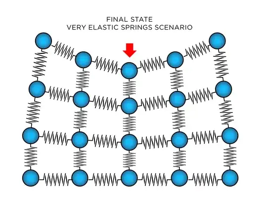

But if the solid is not so solid (the springs are more elastic, less reactive to expansions and contractions, less rigid), you can see that the force will get distributed in such a way that the "solid" would deform. Your concentrated pressure would not be distributed fairly in the top layer (even if it will always be distributed in the entire lattice). The end result (when things stop moving) would look like this:

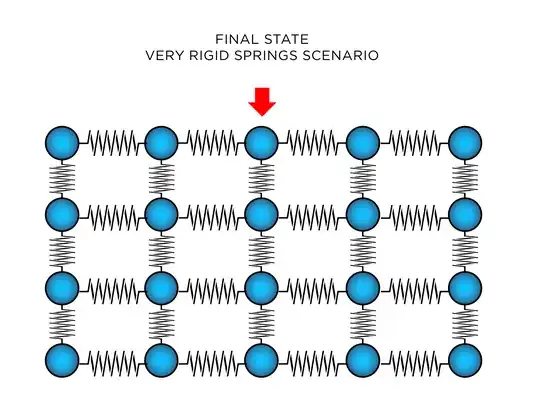

It all depends on the strength of the springs; the cohesive force of the solid. The absolutely rigid scenario is impossible, but since electromagnetic "springs" (chemical bonds) are extremely non-elastic (they react strongly to any attempt to compress or extend them), the solid looks a lot like that (it gets compressed uniformly from above). In the elastic case you have materials like jello that you can press on a point, and the entire thing will deform as in the previous image while you maintain that force. But jello is in the other end of the "solidity" spectrum.
So as you can see you can't push an atom independently of the others in a solid because it will push and pull its neighbours until the entire lattice has redistributed your initial force and every atom has been dragged by that single atom by means of its spring connections to the others.

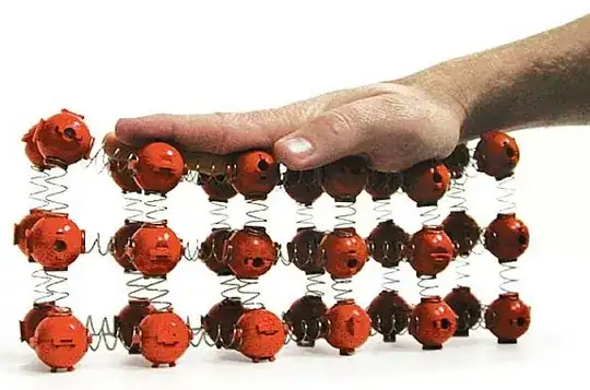

You can even buy or build a toy model of this system (in 3D it is even more realistic) and play with it to grasp the idea of how solids behave under distributed or concentrated pressures.
It is great to play with this microscopic model of solid matter in your hands. You can understand all the aspects I mentioned of how this system works and get to strengthen this understanding deep inside your brain.

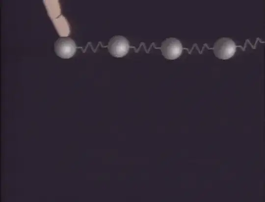

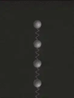

Let's do it now, at least vaguely. We can focus for a moment our attention on the column of atoms just below the $C$ atom, ignoring the rest of the system. This is also a solid: a vertical rod with only one atom of width. Let's see how your force propagates downwards using this animation I extracted from "The Mechanical Universe" series.
We could totally calculate each and every interaction for each instant in time by simply using Newton's Laws of Motion and Hooke's Law (which describes the specific nature of forces exerted by springs). But this is, as I said, impractical when the number of atoms and springs is large. But! Only watching a few of these atoms you can get the sensation that there is a macroscopic (a wide context understanding) behaviour for the system. It looks like the perturbation is been propagated; it looks like a wave!
So we can avoid calculating billions of interactions because the reality is that this is just a wave propagating downwards (more like a pulse but still a wave). We have equations that perfectly and simply describe how waves behave, so this has to be used. In particular this wave is a longitudinal wave.
What about the other atoms in the lattice? Well, let's focus for a moment on the atoms of the same row of $C$ and only on the ones at right-hand side. We are moving $C$ downwards so the interactions would look like this animation:
Again this looks a lot like a wave propagating (since the force has actually to be distributed in a finite amount of time). But the difference is that in this case the wave is not longitudinal but transverse.

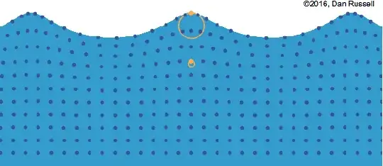

But there is something to note: in the previous animation atoms move up and down only (they might be fixed with a vertical rod, each of them, where they can slide). In our system this is not a limitation, and since $R$ is not only pushed downwards by the displaced $C$ but it is also pushed to the left, the actual wave is a combination of longitudinal and transverse oscillations. The same complex waves that we see in the oceans:
Look at those atoms and how they oscillate in circles (nor only back and forth and not only up and down but with a combination of both motions). Also, your solid is not only this layer nor the previous column of atoms, it is both, and each part of the lattice will suffer the propagation of these complex waves in different forms depending on the distance from $C$ and the orientation.
Because of symmetry, this wave is not only propagating to the right of $C$ but also to the left of $C$. And also remember, yours is not a force applied with oscillating intensity but it is just a pulse, a single wave front. When the wave front has propagated to the entire solid, the situation ends (our springs damp any future oscillations, and we reach the equilibrium/static state).

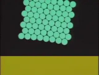

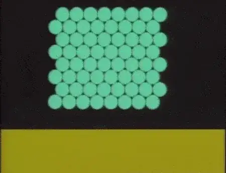

Finally I want to point to this simulation of a solid block of just a few atoms colliding with the floor.
Look at how I lied a little on the fact that we reach a static final situation: after compression, all these springs keep interacting with each other (all the waves keep bouncing inside the solid, reflecting and interfering with themselves in a complex way). The solid never ceases to change shape (in minuscule amounts). These interactions become background noise vibrations, and these vibrations is what we perceive, as macroscopic beings, as the temperature of the object. There is no damping.
What's interesting in the animation is that the atoms were not vibrating randomly before the impact of the object. With our atom-spring lattice model we can show that a solid object moving with certain kinetic energy will indeed heat up a little when colliding with another, part of the energy is kept as the overall kinetic energy of the block as it bounces upwards again, but a fair amount of the original energy is not stored as random movement of the molecules of the solid. This is the reason why objects don't reach the same altitude after bouncing on the floor. All of this is explained just by this simple model!
Just as a bonus, this is the second bounce: you can see that now it is just one atom that suffers the force in the collision (instead of the entire bottom layer of atoms of the previous animation). This is similar to the experiment of your question.
Look at how the wave propagates so quickly that it is almost invisible in both GIFs. It is just a few frames. In the first one it is more visible: the wave traverses the solid from bottom to the top in less than half a second.

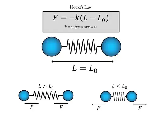

Since you are so particularly interested in the actual force distribution and how does it work I'm going to expand here on the small details of how an actual calculation can be made for a network of interconnected masses attached by springs.
For that we first need to understand the nature of the forces involved. Since they are springs we can use Hooke's Law;
$F=-k(L-L_0)$
Which tells us that the force excerted by a spring is proportional to the stretching or contraction of it. $L_0$ is the length of the spring when it is in the relaxed state, and $L$ is the length of the string in general. So $L-L_0$ is the change of length of the string from that relaxed state. $k$ is the stiffness coeficient of the string. And the minus (-) sign is there because for an expasion ($L-L_0>0$) the force has to go in the direction of contraction and for a contraction ($L-L_0<0$) the force has to point in the direction of expansion.

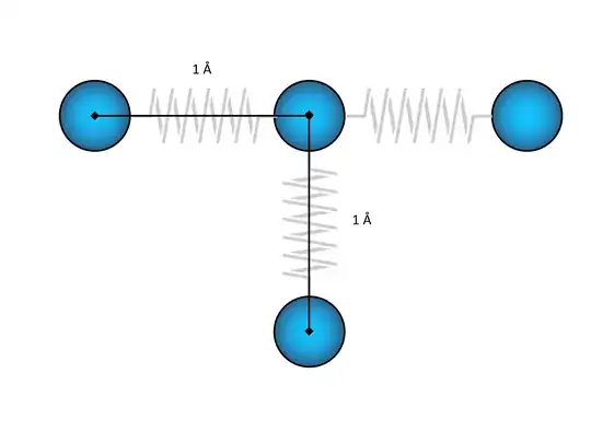

Now let's immagine our simple model: four atoms, connected by springs in a configuration identical to that of our $C$, $R$, $L$ and $D$ atoms. The distance between adyacent atoms is 1 angstrom (a tenth of a nanometer). This distance will also be the relaxed length of each of our springs. Which means that on this configuration they are under no tension at all. So we have $L_0 = 1 \;angstrom$ for all the springs.
Now suppose that I fix the positions of the $R$, $L$ and $D$ atoms holding them while we change the position of the $C$ atom. All the springs then are going to change in size depending on where I put $C$, and thus all the strings are going to excert a force on $C$ (a force that wasn't there before in the relaxed situation).

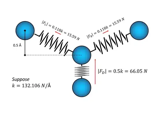

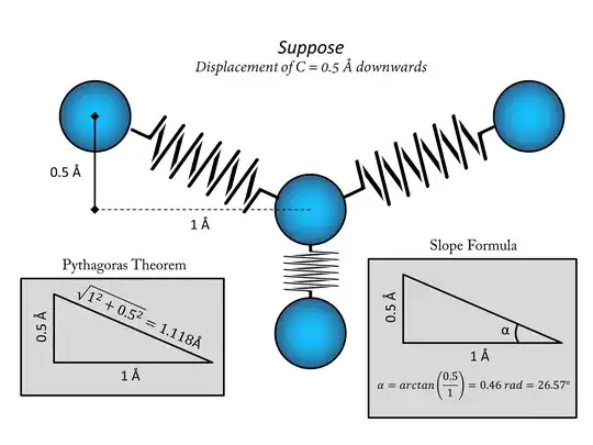

So, to give some concrete numbers I will move $C$ in the downwards direction for 0.5 angstroms (half the way to the $D$'s position). Now the length of the $C-D$ spring has decreased to 0.5 angstroms, and thus a force should appear in the upwards direction (since the contraction happened in the downward direction and Hooke's law has that "-" sign in front of everything). So the force excerted by this string on $C$ is going to be $F_D=-k(L-L_0)=-k(0.5-1)=k/2$. But the lengths of the $C-R$ and $C-L$ springs has also changed. The new length can be calculated by using pythagoras theorem since the springs lengths can be regarded as the hypothenuses of a right triangle with base 1 angstrom and height 0.5 angstroms:
As you can see, the lengths of the $C-R$ and $C-L$ springs are now both equal to $L=\sqrt{0.5^2+1^2}=1.118\; angstroms$. From basic trigonometry we know that the angle at which these springs are inclined with respect to the horizontal is the inverse tangent of the slope and the slope is the ratio between height and base. So, the force of the $C-R$ spring is going to be $F_R=-k(L-L_0)=-k(1.118-1)=-0.118k$ which is negative because the force is pointing in the opposite direction of expansion (which is considered positive), and the force of the $C-L$ spring is going to be $F_L=-k(L-L_0)=-k(1.118-1)=-0.118k$ which again is the same (note how since the system is mirror symetric we could have avoided this calculation by just saying "they have both to be the same because of symetry"). The only difference between them is that the direction of expansion is defined positive differently on them, the $C-R$ spring expands to the left end and the $C-L$ spring expands to the right end, thus the forces are pointed one to the right and the other to the left, both inclined with respect to the horizontal at $\alpha = 26.57^\circ$.
So let's suppose one final parameter of our model. Let's say that $k = 132.106\; N/angstrom$. This means that the strings in our model are able to react with $132.106\; N$ of force for each angstrom we expand or contract them. Since we have contracted the $C-D$ spring by half an angstrom the intensity of the force (regardless of signs) is $|F_D|=k/2 = 66.05\; N$. For the force of the $C-R$ and $C-L$ springs we have $|F_R|=|F_L|=0.118k=15.59 \; N$ each.

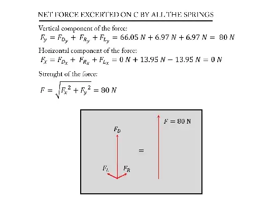

Since we now know the value of each force applied on $C$ when on this particular position by the three springs, and since we also know how those forces are oriented (one is pointed downwards, the other is pointed to the upper-left with an angle of $26.57^\circ$ and the last one is pointed to the upper-right with the same inclination of $26.57^\circ$), we can compute the net force applied on $C$. We only need to decompose the forces in their horizontal and vertical components. This can be done with simple trigonometry like so:
Finally we can compute the horizontal component of the net force as the sum of the horizontal components of the all the forces and the same with the vertical component. Having both vertical and horizontal total contributions we can finally obtain the actual value for the net force and its direction:
All the horizontal contributions of the different forces cancel each other out perfectly in this configuration, and only the vertical contributions add up.
So the final answer here is that if $C$ moves to this particular position it will be subjected to a lifting force of $80\; N$. Why $80\;N$? Because I choosed the value of $k$ and the value of the displacement of $C$ such that this would be the result in our model.
This system is not in equilibrium since the net force on $C$ is not zero. That means that if I let $C$ go from this position it will start to move upwards. While it changes position the springs are going to change lengths and the net force might change. If the movement is attenuated (by some added up friction or heating of the springs) then ultimately after some oscillations the entire system will return to the initial T-shape configuration (since in that situation we saw there was no net force, thus no change).
But! if instead of letting $C$ go you were pushing it with $80\;N$ downwards then the total net force would be balanced! because you will be canceling these spring forces with that of you pressing on this particular atom with that particular force.
So, your original question is actually this problem but in reverse. You push with $80\;N$ of force downwards and with this reasoning it has been shown that after 0.5 angstroms (if and only if the stiffness of the springs is k$=132.106\; N/angstrom$) the entire system would be at equilibrium and your applied force would be exactly balanced by the others so anything would move after that. The reality (as someone pointed out) is that, because of inertia, after passing the 0.5 angstroms tick your $C$ atom would keep moving towards $D$. But as it does that the total force on $C$ is going to change to an upwards force and thus the $C$ atom would in fact oscillate around the 0.5 angstrom position forever. If there is some damping then it will come at rest to that Y-shaped configuration.

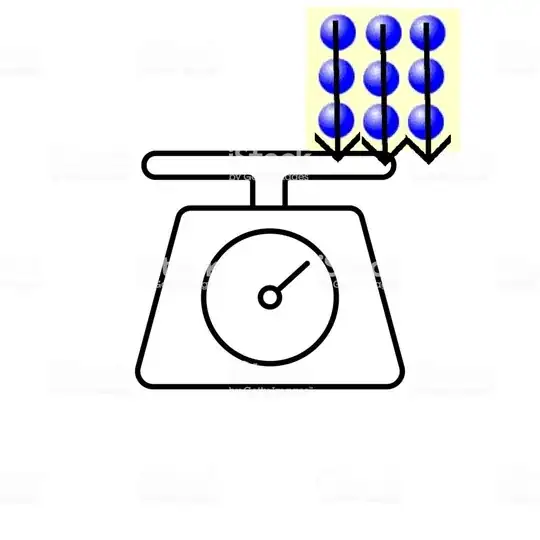

So now take 2 layered 3 molecules now if we apply $80\,$N on first layer then $80\,$N will be given by bottom layer as first layer is at equilibrium then using newton's third law $80\,$N will act on second layer by first layer as it is also at equilibrium then table must be giving $80\,$N in opposite direction so this layer must be getting $80\,$N force by table, so we say body gets normal reaction by table. And mass balance case similarly you can take equilibrium of each atom and proceed and remember the balance measures normal reaction to show reading.

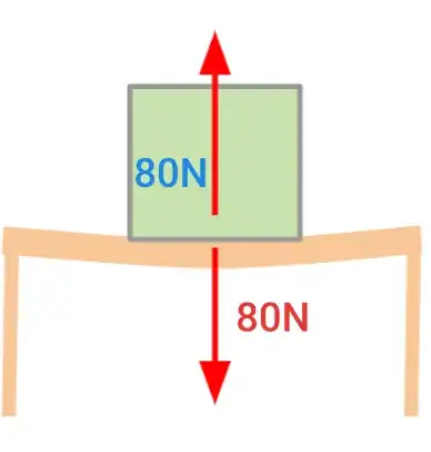

Consider a box placed on a table on earth the normal forces are internal forces of the table-box system and prevents the box from falling down to earth.
Now consider the same case of table-box system but with a different situation in which a boy is pushing the box from the top towards the table. Now normal forces occur between the table-box system as well as box-boy system.Now suppose the box is in equilibrium then $$\vec{F_{B,b}}+m\vec{g}+\vec{F_{t,b}}=0$$
$\vec{F_{B,b}}$ is the force applied by boy on box. $\vec{F_{t,b}}$ is the force applied by table on box.
So,I think this equation in itself governs the whole dynamics of the box in equilibrium.I tried my best to explain the issue addressed by you.
