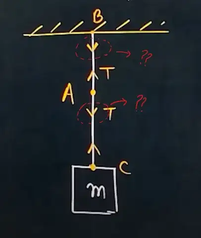

I have recently started studying the Tension force and came across this diagram{attached below} of tension forces on a string and am unable to comprehend that how the direction of the tension forces are put below the point A and below the point B(which is fixed and rigid).
Shouldn't the tension force just point upwards the whole time because on a deeper level it is just due to electromagnetic forces? The mass attached on one end pulls the rope molecules farther away to which the molecules should respond by applying a force upwards to counter the downward force by the weight and hence in theory there shouldn't be any fore acting downwards by the string
The explanation for putting the arrows this way was given that the tension force is a pulling force and hence pulls each point although I think it dosen't make any sense. How is the tension force by the rope/string acting downwards at points B and A if it should instead act upwards to counter the force by the weight? Is the diagram incorrect or is my understanding of Tension force just incorrect all along? If so please help by providing an intuitive understanding of the cause and reason of Tension force.

The picture you show us is correct in that it shows both force directions, but it does not make clear which part causes the force and which one receives it.
If I were to draw that image, I'd reverse the four arrows, so they are located at the part that receives the force. Then e.g. below A we'd see an upwards force, one that operates on the lower part at that point short below A.

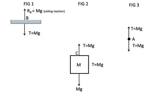

Keep in mind that the tension force can act in either direction depending on whether you are looking at it as an internal force or an external force and how you draw the free body diagram (FBD). To see how this occurs you need to draw free body diagrams individually for the ceiling, block, and string connecting the block to the ceiling.
FIG 1 below is a FBD of the ceiling, FIG 2 a FBD of the block, and FIG 3 a FBD of the string (section including point A). Note in FIG 1 the tension is shown downward, since that is the external force acting downward on the ceiling. In FIG 2 is is shown upward since it is an external force acting upward on the block. Internal to the string at any section (such as that including point A) the tension forces (assuming a massless inextensible string) are equal and opposite for any section of the string.
