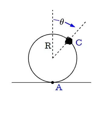

A massless cylindrical tube of radius $R$ with infinitesimally thin walls has an infinitesimally narrow rod of mass $m$ attached to its inner surface, parallel to the tube. The tube is then laid on a floor so that the rod is in the uppermost position, and then is released to roll away from that unstable equilibrium position. The floor isn't slippery, so there's no sliding. The cross section of the tube looks like the following (from ja72's answer):

Solve using the center of mass
fig1
Put the origin at the contact point, and describe the position of the rod as $$\boldsymbol{r}_C = \pmatrix{x + R \sin \theta \\ R + R \cos \theta \\ 0}$$ where $x$ is the horizontal distance the center of the tube moves. The no slip condition has $x = R \theta$, as well as $\dot{x} = R \dot \theta$ and $\ddot{x} = R\ddot{\theta}$.
In this case, the MMOI about the center of mass is 0, and therefore the angular momentum about the center of mass is also zero. So the torque about the center of mass should be zero.
$$ \boldsymbol{\tau}_C = (0-\boldsymbol{r}_C) \times \boldsymbol{A} = \boldsymbol{0} \tag{2}$$
where $\boldsymbol{A} = \pmatrix{F_A \\ N_A \\ 0}$ is the contact force vector. This leads to the expression of $$F_A = N_A \tan \left( \frac{\theta}{2} \right)$$

Solve using the Contact Point
Take equation (1) at the contact point A.
$$\boldsymbol{\tau}_A = \tfrac{\rm d}{{\rm d}t} \boldsymbol{L}_A + \boldsymbol{\dot{r}}_A \times \boldsymbol{p} \tag{5} $$ with
$$\begin{aligned} \boldsymbol{\dot{r}}_A & = \pmatrix{R \dot \theta \\ 0\\0} \\ \boldsymbol{p} & = m \boldsymbol{\dot{r}}_C = \pmatrix{m R (1+\cos\theta)\dot\theta \\ -m R (\sin \theta )\dot\theta \\ 0} \\ \boldsymbol{\tau}_A &= (\boldsymbol{r}_C-\boldsymbol{r}_A) \times \boldsymbol{W} = \pmatrix{0\\0\\-m g R \sin \theta} \\ \boldsymbol{L}_A &= \boldsymbol{L}_C + (\boldsymbol{r}_C-\boldsymbol{r}_A) \times \boldsymbol{p} = \pmatrix{0\\0\\ -2m R^2 (1+\cos\theta) \dot \theta} \end{aligned}$$
Remember that angular mometum about the center of mass is zero here $\boldsymbol{L}_C =\boldsymbol{0}$.
So the derivative of angular momentum is
$$ \tfrac{\rm d}{{\rm d}t} \boldsymbol{L}_A = \pmatrix{ 0\\0\\ -2mR^2 \left( (1+\cos \theta)\ddot \theta - (\sin\theta)\dot \theta^2 \right)} $$
and the solution is
$$ \ddot \theta = \frac{g + R \dot \theta^2 }{2 R} \tan \left( \tfrac{\theta}{2} \right) \; \checkmark \tag{6}$$
