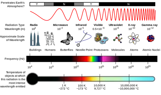

Here's a diagram from that article.
spectrum diagram
In practice, gamma ray energies overlap with the range of X-rays, especially in the higher-frequency region referred to as "hard" X-rays. This depiction follows the older convention of distinguishing by wavelength.
