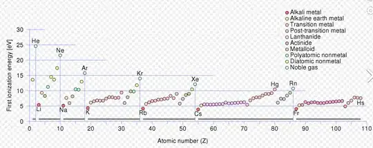

Ionising an atom by removing an electron requires that the photon carries the needed binding energy. The binding energy of an electron is of the order of few $eV$.
enter image description here(copied from wiki)

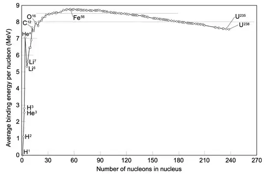

Instead, if you liked to remove a proton from the nucleus, the photon would need to carry the binding energy of a few $MeV$ -- check out the mass defect, which is often stated as "average binding energy per nucleon".
Hence, taking only this argument, the photon with $\lambda=100nm$ is not able to remove a proton.
