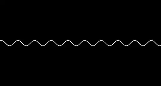

Slow acceleration makes weak radiation. We detect radiation only when its effect on atoms is detectable, and the radiation from slow acceleration is not easy to detect! It's easiest when many charges are accelerated together, at a frequency that some arrangement of atoms is particularly ready to be affected by. So a radio tower accelerates a lot of elections linearly together in a sine wave, and radio receivers can detect that if they are tuned to the right frequency.

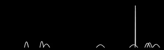

Fast acceleration can produce strong radiation which has big effects without needing a periodic wave. It can be aperiodic and still get observed. And that's mostly what X-ray tubes produce. A fast-moving electron which gets close to a nucleus will bend around it, that's acceleration. A short pulse. How much energy in the pulse? It depends on how close it got. Wavelength? Frequency? That doesn't mean much in this context.
wave from radio tower wave from radio tower
wave from X-ray machine wave from x-ray machine
In theory you could get radiation as high-energy as you want, by increasing the voltage. But most of the radiation would be x-ray or lower energy. See the Increasing the Tube Potential (kV) graph in this link.
