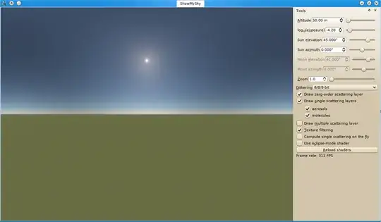

This is an oversimplification, but for a clear sky at daytime it's not too wrong. See the following comparison of an atmosphere model computed with only single scattering and that including 4 orders of scattering (basically, 4 direction switches per light ray). The projection here is equirectangular, so you can see all the directions in one picture.

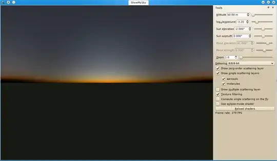

This becomes a much more problematic simplification when the sun is under the horizon, particularly noticeable under the belt of Venus, where the Earth's shadow is located:

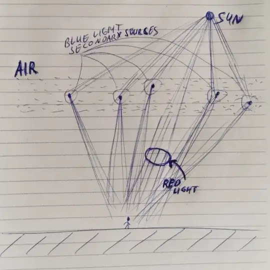

Short explanation is this. Red light comes directly from Sun almost un-scattered or scattered to small degree. And when blue light enters atmosphere it gets scattered by air molecules a lot in each direction, thus according to Huygens-Fresnel principle making each point in atmosphere as a secondary sources of blue light. These blue light sources adds-up along the direction of view, which in the end increases intensity of blue waves, compared to the red ones which reaches us only directly from Sun. So speaking by analogy, Earth atmosphere acts as a some sort of optical lens, focusing blue light towards direction of view. Schematics :
Of course this is a bit oversimplified, because blue light is scattered in ALL directions across the air. You can imagine a thousands of blue light bulbs turned-on in the sky. Maybe this would be better analogy, because each point in air acts as an ambient light source for blue waves.

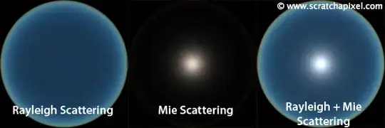

This is perfectly illustrated by a calculated sky image that shows the separate contribution of Rayleigh and aerosol (Mie) scattering (taken from this website, which does quantitative calculations, but which does not take account of multiple scattering). The sky is quite white near the horizon, then becomes a deeper blue at higher angles and is finally quite white again near to the Sun because of Mie scattering. Rayleigh + Mie scattering

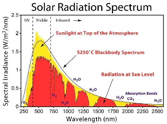

Your final point, I've already covered. Yes, direct sunlight arriving at the surface of the Earth is "redder" than received at the top of the atmosphere. Plot below from https://commons.wikimedia.org/wiki/File:Solar_Spectrum.png
