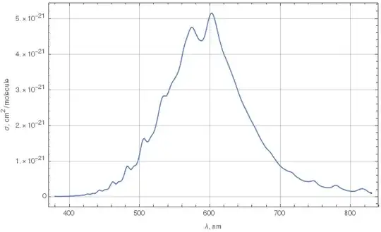

Ozone doesn't absorb blue light (much): on the contrary, it absorbs red light much more, thus making the sky look blue. See in particular my answer for the question at Chemistry.SE: What exact color does ozone gas have?. Here's spectral cross section of ozone absorption in the visible(+NIR) range — the Chappuis band:
Chappuis band spectrum

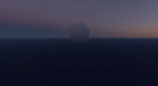

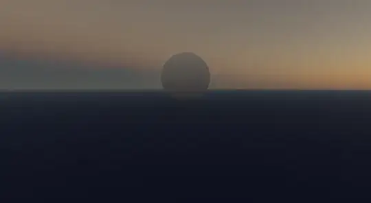

I have actually tested this ozone explanation of blue hour, using the Precomputed Atmospheric Scattering code to render two versions of the same scene: one for atmosphere with an ozone layer and another without any ozone. Here are the renderings of the Belt of Venus (ignore the white sphere in the center, it's just an irrelevant part of the demo scene):
With ozone layer (the normal Earth atmosphere):
Without any ozone:

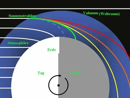

The reason is the same as in rainbow; different colours (wavelenghts)bends differently (sorry my language).
This Blue hour is the sunlight which arrives below the horizon. The reason why other light doesn't is on their wavelength. The Blue light can bend the most, and thus it can still reaches the Earth surface an hour after sunset, while green, yellow and red are already going above our heads.
This picture form german language Wikipedia on topic "Grüner Blitz" pretty much explains the issue. So there actually even is a green flash between "golden hour" (Red-orange-Yellow) and the blue hour.
