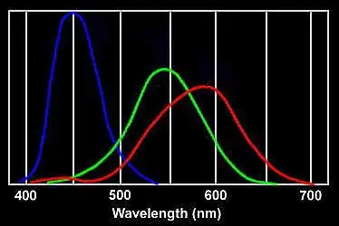

This is from the Physics FAQ article that I wrote 15 years ago:
If shorter wavelengths are scattered most strongly, then there is a puzzle as to why the sky does not appear violet, the colour with the shortest visible wavelength. The spectrum of light emission from the sun is not constant at all wavelengths, and additionally is absorbed by the high atmosphere, so there is less violet in the light. Our eyes are also less sensitive to violet. That's part of the answer; yet a rainbow shows that there remains a significant amount of visible light coloured indigo and violet beyond the blue. The rest of the answer to this puzzle lies in the way our vision works. We have three types of colour receptors, or cones, in our retina. They are called red, blue and green because they respond most strongly to light at those wavelengths. As they are stimulated in different proportions, our visual system constructs the colours we see.
When we look up at the sky, the red cones respond to the small amount of scattered red light, but also less strongly to orange and yellow wavelengths. The green cones respond to yellow and the more strongly scattered green and green-blue wavelengths. The blue cones are stimulated by colours near blue wavelengths, which are very strongly scattered. If there were no indigo and violet in the spectrum, the sky would appear blue with a slight green tinge. However, the most strongly scattered indigo and violet wavelengths stimulate the red cones slightly as well as the blue, which is why these colours appear blue with an added red tinge. The net effect is that the red and green cones are stimulated about equally by the light from the sky, while the blue is stimulated more strongly. This combination accounts for the pale sky blue colour. It may not be a coincidence that our vision is adjusted to see the sky as a pure hue. We have evolved to fit in with our environment; and the ability to separate natural colours most clearly is probably a survival advantage.

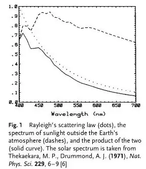

The figure below (Bohren, Atmospheric Optics, http://homepages.wmich.edu/%7Ekorista/atmospheric_optics.pdf ) below shows the result of multiplying the solar spectrum by the $1/f^4$ of Rayleigh scattering. This gives us a spectrum that is strongly peaked in the violet, but that still has quite a bit of light throughout the rest of the spectrum.
This is all assuming single scattering. Multiple scattering also occurs, and is most common near the horizon. Multiple scattering brightens the light and equalizes the intensities of the different wavelengths.
We also have haze and possibly other forms of particulate matter such as smog. This produces Mie scattering. Mie scattering on a cloud of particles with a range of sizes produces more uniform scattering as a function of wavelength than Rayleigh scattering.
The net result of multiple scattering and Mie scattering is to whiten the color of the sky considerably.
