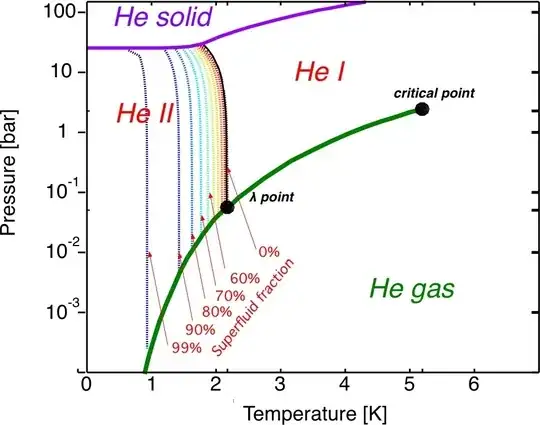

To understand the effect of pressure, we look at the following phase diagram of He(4), where we see that the liquid/gas forms continue down to ~0 K, if the pressure remains below 25 atm. The figure distinguishes the two phases He-I and He-II separated by the black line. The superfluid fraction is shown to increase dramatically as the temperature drops.
