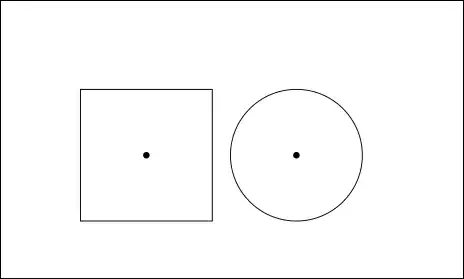

Let's say I have these equal size objects (for now thinking in 2D) on a flat surface.
At the center of those objects I add equal positive angular torque (just enough to make the square tire to move forward).
Of course the round tire will move faster forward and even accelerate (I guess). But how can I mathematicaly prove/measure how better the round tire will perform?
This for my advanced simulator I'm working on and I don't want to just Hardcode that rounds rolls better, square worse, etc.
I know the answer could be very complex, but I'm all yours.

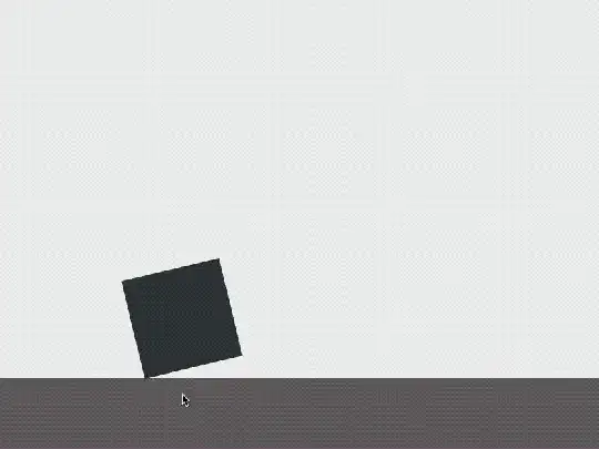

Rolling Square
As you can see in the GIF below, the rolling square has a kind of wobbly rotational motion. Wobbly in the sense that its center of mass goes up and comes down, goes up and comes down, and on an on.
Animation source
So as we calculated above, we need to do some work to raise the height of the square's center of mass (There's a specific angle, $45^{\circ}$ in this case, up till which you need to rotate the square if you want it to roll. If you rotate the square by an angle less than that, then the square would fall back). And once the center of mass reaches the maximum height, it then falls to the other side on its own and the kinetic energy gained by the square during the fall gets dissipated as sound and heat energy due to the inelastic nature of collision of the square with the ground. Now you would again have to raise the square's center of mass up to make it roll. This process continuously involves giving energy to raise the center of mass and then losing the energy because of the square falling back to the ground. And this makes it really difficult for a square to roll.
Why does it undergo inelastic collisions?
The square is prone to lose more energy due to inelastic collisions when compared to a circular disc because of a larger area of the surface which is in contact with the ground. This is similar to the case of a bicycle tyre. When the tyre is inflated, it is spherical and thus has a lower are in contact with the ground resulting in lower energy loses, whereas a deflated tyre has a larger area in contact with the ground which makes it more prone to inelastic collisions.

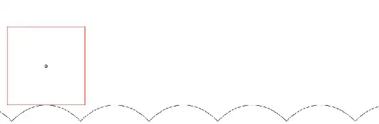

For special surfaces, you can even make a square rotate like a sphere. See the GIF below.
Animation source
As you can see, if we use a surface which is made up of inverted Catenary curves, we can even make a square roll. To see why this is true, you can check out the derivation here.

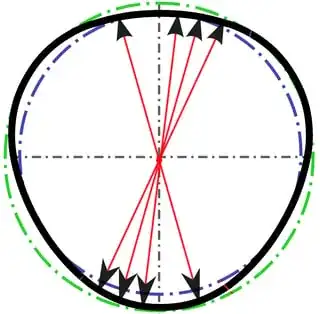

Circular objects are not the fastest.
Any other smooth convex shape can roll faster than a circle. As a random example, this shape (picture found on wikimedia) can roll faster than a circle:
trilobular shape
Start it in the orientation shown. This is the orientation where its center of mass is highest. Then it will generally be rolling faster than the circle due to having converted some of its potential energy to kinetic energy. Only at those instants where its center of mass has returned to the original height will it be going as slowly as the circle.
Even your example of a square will go faster than the circle, if you replace the flat sides with slightly bulging sides and round the corners slightly, and rotate it 45° so it starts out "standing on a corner".

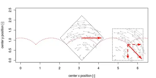

I think that in perfect conditions, the square and the circle roll AT THE SAME SPEED. The reason for this is that in real life, a circle will roll faster than a square for friction reasons: the kinetic energy of the square will get lost faster than the energy of the circle because of it's shape and go to thermal energy. But in perfect conditions,without friction, there is no reason that the square rolls slower than the circle, except if the energy that you apply to it is less than needed so that it flips 45 degrees, but if it isn't the case, the potential energy will go to kinetic energy and vice versa forever, moving the square less regularly but at an average that is equal to the circle. I think that this question is an intuition problem of how things happen in "perfect conditions", in the same way that two objects fall at the same speed when there isn't any air friction.
You do not apply torque at the center, a single point. It requires at least two points. This is an important detail. Because the second force applied to the object is a friction force. This friction force will be different for the round and square wheels. With a different friction force the object will experience a different impulse and obtain a different translational momentum (impulse will be related to the difference between friction and pull forces multiplied by the time)
For the round wheel, the friction force will be smaller because less torque is needed to make the circle move and rotate. This difference can be computed by considering the moment of inertia.
Computation by moment of inertia
The moment of inertia around the center is for square and round: $$\begin{array}{} I_{square} &=& \frac{1}{6}mD^2\\ I_{round} &=& \frac{1}{8} mD^2 \end{array}$$ with mass $m$ and D the height/diameter of the wheel.
As seen in the image below for a given speed at the center and a given rotation, the square does not have a continuous speed in the horizontal direction (which will go along with variations of friction and bouncing, but let's assume a perfect situation where this does not lead to energy dissipation).
We can compute the average speed by relating the circumference of the wheel ($4D$ for the square and $\pi D$ for the round).
So the relative ratio of average horizontal speed $v_h$ and angular velocity will be
$$\begin{array}{} \omega_{square} &=& \frac{1}{4} (v_h/D)\\ \omega_{round} &=& \frac{1}{\pi} (v_h/D) \end{array}$$
The square is moving faster than this speed because it is making a longer path. For a distance of $D$ in horizontal direction (one quarter flip) it follows a path of 1 quarter circles with radius $\sqrt{0.5}D$ and the length is $\sqrt{1/8} \pi D$.
So for a given translational velocity $v_h$ the energy needed is
$$\begin{array}{} E_{square} &=& I_{square}\omega_{square}^2 + (\sqrt{1/8} \pi)^2 mv_h^2 &=& \left(\frac{1}{96} + \frac{\pi^2}{8} \right) mv_h^2 & \approx & 1.244 mv_h^2\\ E_{round} &=& I_{round}\omega_{round}^2 + mv_h^2 &=& \left(\frac{1}{8 \pi^2} + 1 \right) mv_h^2 & \approx & 1.013 mv_h^2 \end{array}$$
So to move the square with a certain average horizontal velocity, you need more energy. This difference has been computed above by considering energy, but the mechanism is a difference in the friction force between the wheel and the surface (differences that need to match the difference in momentum along the horizontal direction). If the square wheel is pulled at the center, and a rotation plus translation comes from this, then this needs to coincide with a frictional force at the bottom. This friction will be bigger for the square wheel than the round wheel.
square movement
