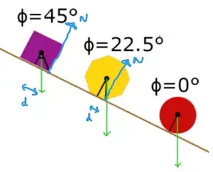

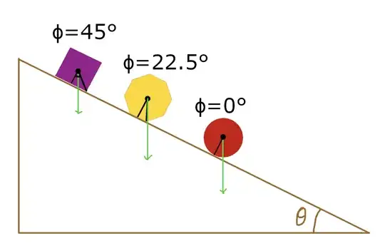

There's an interesting subtlety here - the difference between rolling fast and rolling at all.
The second question is easier. For a polygon to start rolling down the hill, we need only one thing:
$\theta > \phi$, i.e. the object's center of mass (think of it as the "middle" of an object) is past the furthest corner of the polygon.
Take an assembly of shapes on a hill:enter image description here
In this situation, the square is stable, the circle is unstable and will roll, while the octagon is just on the verge of moving. In general, an $n$-sided regular polygon has $\phi_n = \frac{180^\circ}{n}$ - as $n\to\infty, \phi_n \to 0$, i.e. by adding more sides and making the shape rounder, you decrease the angle needed to get it moving.
EDIT: a comment pointed out that the first condition was not needed. Even if the static friction is weak and the square begins sliding, it still will not roll unless the center of mass (black dot) is to the right of the support point (black line).
However, this analysis assumed that the shape started at rest, flat side down. If the octagon were given a push to get it started, it would also roll, but in a jagged "bumping" motion that would dissipate kinetic energy with each corner impact. This is the more difficult, first question, "Once rolling, which one accelerates faster?", which was already thoroughly answered in the linked question.

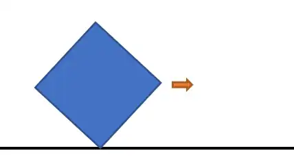

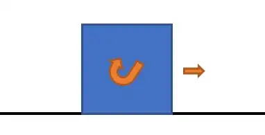

Because the square spends time converting kinetic energy to potential (and vice versa), and the circle doesn't.
Consider a perfectly elastic square rolling along a frictionless horizontal surface with horizontal and angular momentum (so it has no way to shed its energy and stop moving). Think about the square in this position:
Think about how it can "hover" at this spot for a long time if it has just barely enough leftover kinetic energy to topple it forward and keep it moving. Most of the energy of its movement has converted to potential energy, and as it falls it will get converted back to kinetic energy, mostly in the form of angular momentum.
That energy will carry it back up to that same point, where it again hovers and just barely makes it over the hill. As you increase the starting energy, getting over this hill becomes easier and easier and the rolling speed approaches the circle's. On the other hand, you can decrease the energy to add more and more "barely"s to just barely making it over the hill, and make it hover at the top of each hill arbitrarily long.
A circle doesn't spend any time going up and down this "potential energy hill"; its total energy just stays in the form of kinetic energy the whole time.

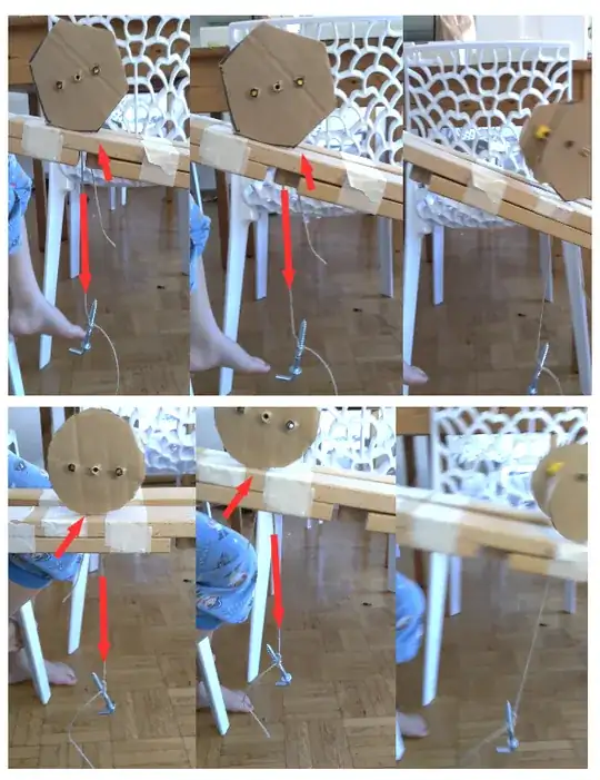

Based on some tips we have done some experiments
Experiment 1, the tipping over
The answer by catalogue_number mentions that a circle, or shapes with a small base (small edges) will tip easier.
Because the concept of forces as arrows, e.g. arrows depicting forces acting on the center of mass might be too abstract, we made some toy model with lego and cardboard as in the image below.
To represent the gravitational force we took a rope with some weight added to it. This looks almost the same as the arrows in the schematic pictures. What we see is that relative to the point where the object touches the surface the object does not tip when the force(/rope) is not 'pulling beyond' it.
(actually, our construction is a bit bad because the hexagon will eventually slide and when it is hitting the bump from the tape it starts to tip)
For the round object, we noticed that the rope is pulling in a different position relative to the point where the object touches the surface. The round object is tipping over very easily.
position of center of gravity

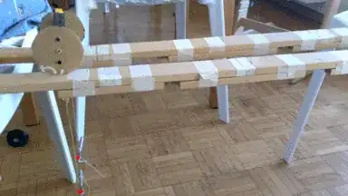

Experiment 2, energy in rotational motion
Changing the construction as above we used two weights. These weights will also move up and down when the object rotates. This motion makes that the gravitational energy is not only going into the motion along the direction of the slope, but also in up and down motions from the weights.
So despite the shape being round, we saw that there is a way to make it move slower. This is by having part of the motion/energy go into the up and down motions of the weights.
internal kinetic energy

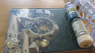

Experiment 3, energy dissipation
In the comments, Ciprian Tomoiagă mentioned a very interesting link to a lecture of Dr. Tadashi Tokieda. We did his experiment with the rice inside the objects.
Like in the second experiment we have again the same shape for the objects. One of the tubes is filled for one-third with rice. Will this change the speed?
Yes it will. The rice inside apparently slows down the motion. It does this without having an effect on the shape of the tube. The rice slows down the tube because it will be pushed up, picking up potential energy, and when it falls down it dissipates the energy.
tubes filled with rice

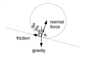

I imagine something like the image below.
forces
Earths pulls and pushes the ball and vice versa. There will be some resultant net force that makes the ball move relative to earth.
So if something inside the ball causes friction, like the rice, or if something inside the ball takes up some of the energy, like rotational and traverse motions, then why should the ball move slower? What force causes this?
Did these frictions or rotational motions change the resultant force (due to changes in friction or normal force), even when it is the same shape? Well, it must be. We can also see it when the rice example is placed in a static state.
Below we see the forces acting on the object with the rice inside when it is in balance, not moving. There is no torque because the center of mass is above the point of contact. There is a resultant force from the combination of gravity and normal force. If there would be no friction then the object would start to slip. So this static friction force will now be present and it makes the net force zero.
friction

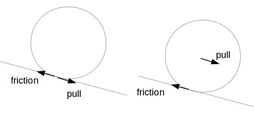

Why would this static friction be gone or smaller when the center of mass is not above the point of contact?
The reason is because now the object can tipple.
We can see this when we imagine doing the experiment in zero gravity and replace the resultant force (from normal force and gravity) by pulling on the object.
difference
When we pull the sphere in the bottom then we get that the pull force and friction balance each other. When we pull at some higher point then due to the torque the object will start tipping/rolling. But can it accelerate when the net forces are zero? No, but the net forces won't be zero. If the object starts rolling (and accelerates) then the friction will be lower than the force by which we pull.
The friction force is originating from the object pushing the earth/surface, and when it is rolling then it is pushing the earth's surface less. (So this is a more complicated version explaining Walter's quick and intuitive answer)
