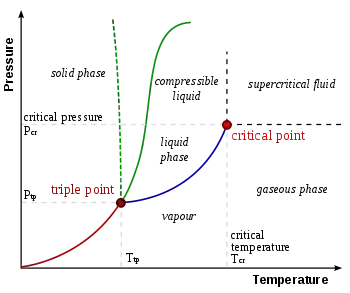

For example, consider the phase diagram of water. If you take water vapor, slowly heat it up, then pressurize it, and then slowly cool it down, you'll end up with liquid water. This entire process is completely smooth. There isn't any sharp point, like a phase transition, where the behavior qualitatively changes; thus we can't make a sharp distinction between liquids and gases.
There are fluids that are "liquid-like" (densely packed, strong interactions between neighbors) and fluids that are "gas-like" (sparse, weak interactions between neighbors) but no dividing line, just like how there's no moment where a shade of grey changes from white to black.
By contrast, ice really can be distinguished from liquid water or water vapor. You can't turn either of the two into ice without crossing a phase transition. At that point, the atoms will suddenly become ordered, and you can see this from a snapshot of their positions.

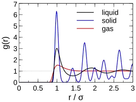

The described measurement would allow you to construct the Radial Distribution Function, the probability of finding another particle a distance r from a reference particle usually given as g(r), which has a unique signature for each phase.
The plot below from https://en.wikibooks.org/wiki/Molecular_Simulation/Radial_Distribution_Functions shows g(r) for argon in different phases.
Argon of course does not have strong interactions you might be tempted to argue this is a trivial case of an ideal gas vs. a close-packed liquid but that would be incorrect. A real gas only has one peak (called a coordination sphere), while a liquid will have multiple peaks. All of this is very nicely explained in the link above.
Also note in the image provide the x-axis is normalized by $\sigma$ which is the molecular diameter meaning that this measurement is scale invariant and satisfies the conditions laid out in the question.

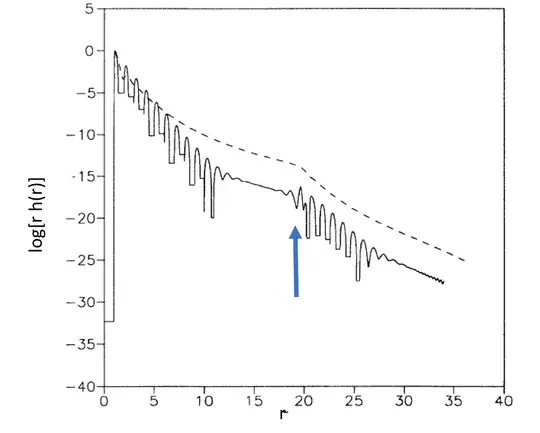

A few candidates for separating liquid-like vs gas-like behavior have emerged ( see this wikipedia page for a short reference): the Widom line is the above-mentioned line of anomalies. Another line, the Fisher-Widom line, separates the region of asymptotic exponential decay of the pair correlation function from an asymptotic oscillating exponential decay. Finally, the Frenkel line is more based on dynamical evidence (it can be defined as the line separating monotonic and non-monotonic decay of the velocity autocorrelation function with time).
I am speaking of “candidates” because the existing experimental evidence is insufficient to allow a sound generalization to every possible case of liquid-gas transition. However, evidence is accumulating, and a few facts have emerged.
Most of the best indicators to differentiate liquid- vs gas-like behavior are dynamical quantities (see a recent paper), thus not suitable to answer the original question. However, one method is directly connected to a purely structural criterion, giving theoretical support to an improvement of the suggestion of looking for a second maximum of the $g(r)$. It is connected to the above-mentioned Fisher-Widom (FW) line. Therefore, it is somewhat related to the appearance of a second peak of the radial correlation function, although it does not coincide with that.
The best available evidence shows that the original FW criterion is only approximate and fails if the interaction range is not finite. A study by Vega et al., where a long-range smooth cut-off of the Lennard-Jones potential was progressively pushed toward larger distances, showed that the FW lines move into unphysical regions. However, looking at the $g(r)$ at intermediate distances larger than the first peak position but not beyond the cut-off point, the presence of oscillatory behavior or not could be a satisfactory indicator of liquid-like or gas-like behavior.
In the following figure, adapted from Fig. 7 in the Vega et al. paper, the intermediate range behavior of the pair correlation function $h(r)=g(r)-1$ (actually the of $log(r h(r))$) has been plotted for a liquid-like state (full curve) and a gas-like state (dashed line) state. The arrow shows the position of the cut-off distance beyond which the pair potential is exactly zero. Figure adapted from Fig.7 of Vega et al. paper
Both curves do not show oscillating asymptotic behavior, but intermediate-range oscillations are clearly visible in the full-line curve.
At the present day, this is the best criterion based only on structural information I could advise.

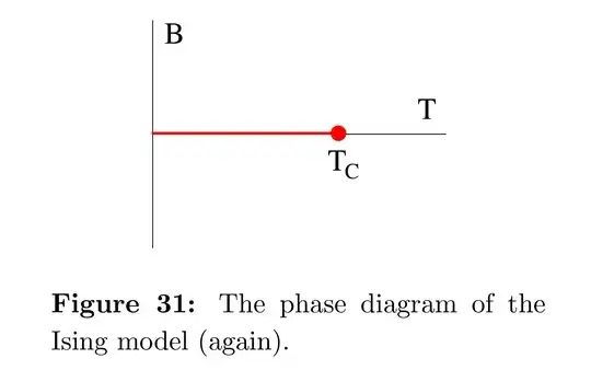

I will try answer your question in the Landau paradigm of phase transition. I follow the beautiful Lectures on Statistical Field Theory by David Tong. See section 4.1.
Phases of matter are characterised by symmetry. More precisely, phases of matter are characterised by two symmetry groups. The first, which we will call G, is the symmetry enjoyed by the free energy of the system. The second, which we call H, is the symmetry of the ground state.
Example 1:
The simplest illustration is the Ising model without a magnetic field. The free energy has a $G = Z_2$ symmetry. In the high temperature, disordered phase this symmetry is unbroken; here $H = Z_2$ also. In contrast, in the low temperature ordered phase, the symmetry is spontaneously broken as the system must choose one of two ground states; here H = ∅. The two different phases – ordered and disordered – are characterised by different choices for H.
Example 2:
In contrast, when $B\neq0$ the free energy does not have a $Z_2$ symmetry, so G = ∅. According to Landau’s criterion, this means that there is only a single phase. Indeed, by going to temperatures $T > T_c$, it is possible to move from any point in the phase diagram to any other point without passing through a phase transition, so there is no preferred way to carve the phase diagram into different regions. However, this also means that, by varying B at low temperatures $T < T_c$, we can have a first order phase transition between two states which actually lie in the same phase. This can also be understood on symmetry grounds because the first order transition does not occur at a generic point of the phase diagram, but instead only when G is enhanced to $Z_2$.
Example 3:
The discussion carries over identically to any system which lies in the Ising universality class, including the liquid-gas system. This leaves us with the slightly disconcerting idea that a liquid and gas actually describe the same phase of matter. As with the Ising model, by taking a path through high pressures and temperatures one can always convert one smoothly into the other, which means that any attempt to label points in the phase diagram as “liquid” or “gas” will necessarily involve a degree of arbitrariness.

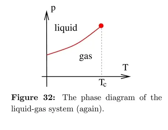

It is really only possible to unambiguously distinguish a liquid from a gas when we sit on the line of first order phase transitions. Here there is an emergent $G = Z_2$ symmetry, which is spontaneously broken to H = ∅, and the two states of matter – liquid and gas – are two different ground states of the system. In everyday life, we sit much closer to the line of first order transitions than to the critical point, so feel comfortable extending this definition of “liquid” and “gas” into other regimes of the phase diagram, as shown in the figure.
So to conclude, there is no differences between a liquid and a gas. One can distinguish between them only when a first-order phase transition occur. But you can easily distinguish solid state from gas/liquid due to differences in symmetry.

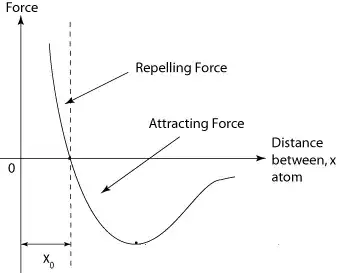

The answer is quantum mechanics (QM) and distance. I will use H2O as an example.
The answer to your question is not surprisingly QM. Liquid H2O has something special between the molecules that gaseous H2O does not have. It is a QM phenomenon, and you can read about it in many ways (van der Waals forces, London forces, and electrostatic forces), but truly it is a QM phenomenon.
The beautiful thing about QM is that there is no difference between the liquid and gaseous H2O molecules themselves. The difference is the force between the molecules (that the molecules only feel at certain distances).
Your question is really: Why is there this force between liquid H20 molecules that gaseous H2O molecules do not have (actually they have it but they are too far apart to feel it)? The answer is distance.
Enter image description here
Do molecules of liquid repel or attract each other?
Now you have to bring these gaseous H2O molecules close together to reach a limit, and when that happens, you trigger QM, and a new QM connection phenomenon is made between the molecules that is attractive at certain distances.
How can you reach that triggering distance? You need pressure. As soon as you add enough pressure to gaseous H2O, it will turn into liquid.
