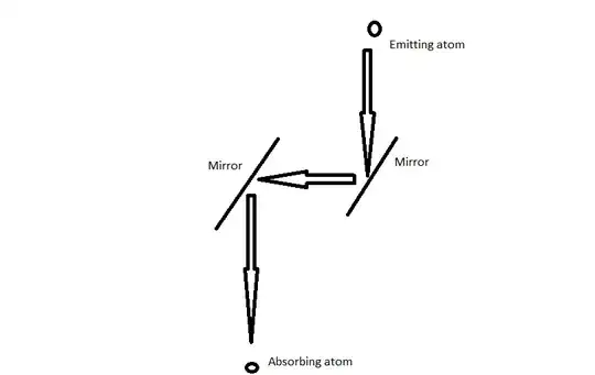

Now I have this setup:
In this setup, the emission and absorption should be separated by a spacetime distance of 0, thus based on the description, the momentum between the emitting and absorbing atom (object) should be transferred directly.
But, the mirrors in between receive something called radiation pressure, that is, the light puts pressure on both mirrors in the way.
Radiation pressure is the pressure exerted upon any surface due to the exchange of momentum between the object and the electromagnetic field.
https://en.wikipedia.org/wiki/Radiation_pressure
To clarify, by directly, I mean that the light (photons) transfer causality between the emitter and absorber, and they do it without any change in its (the lights'/photons') momentum in between.
Question:
  1. Does light (photons) really transfer momentum directly between emission and absorption?

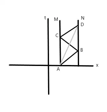

A spacetime diagram might help here. Light travels along a null geodesic while uninterrupted, so the spacetime interval is zero for a $45^{\circ}$ line on the diagram. Reflections are a different matter though, as there is an associated change of inertial frame. Compare with the twin paradox, where one twin travels at a uniform velocity to a different planet, $turns$, and returns back. There is a resetting of clocks and inertial frames associated with turning. Minkowski diagram
In the diagram, the vertical lines M ans N are stationary mirrors, the lines at $45^{\circ}$ is the worldline of the photon. Notice that the gray line is at a higher elevation, meaning that it doesn't travel at the speed of light. This line measures the spacetime interval between events A and D, which here represent emission and detection respectively. The interval is timelike, not null, as you can see.
Momentum of photons changes upon reflection as a result of the change in direction of the photon. The statement that the spacetime interval is null consequently does not hold here.
