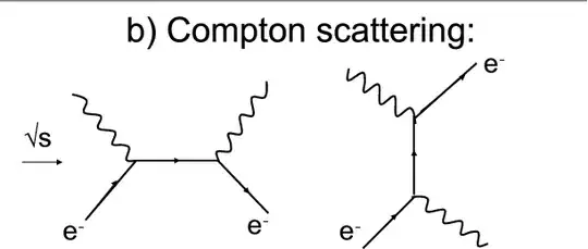

Here are the compton scattering lowest-order diagrams
**There is nothing that forbids elastic scattering **, i.e. energies unchanged in the center of mass and only angles different.
Elastic scattering is logically necessary because if photons were absorbed and re-emitted, the phases between the photons from which the macroscopic classical electromagnetic light wave emerges would be lost, and image coherence would be lost in mirrors. This is what happens with non-mirrors, mainly the scattered photons become point sources incoherently reflected and absorbed. Also, it is necessary for mirror reflection to keep the colors. Absorption and reemission would change the energy, if not elastic, and the frequency of the photons would change and thus the colors built up macroscopically.
To answer the title:
The mirror is macroscopic and its lattice has an effective electric field from the surface atoms. The photon hits the field by exchanging a virtual electron, whereas also the electron on the left is virtual to represent the field because it is tied up in a lattice. The photon scatters elastically in the center of mass, keeping the phases of the emergent beam and thus gives a faithful image back. The center of mass is almost identical to the laboratory center because the mirror is macroscopic and effectively it is the lattice's mass that enters the kinematics (similar to a ball hitting a wall classically).
