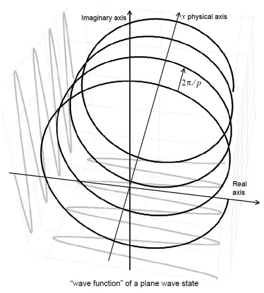

No. As anna v has explained we only ever observe particles. We do not observe waves, but we use them to calculate the probabilities for where particles might be found. Actually, they are not even waves. To take the simplest case, the "wave function" for a plane wave state is actually a helix in a complex valued configuration space. The helix rotates in time, creating the illusion of waves on the real and imaginary axes.
"wave function" of a plane wave state
The reason for apparent wave effects is buried deep in the mathematics of probability theory and Hilbert space, and involves a higher level of mathematics than is commonly taught to physicists. However, it does make completely clear that there cannot be any physical wave, or indeed any physical field. This is just how calculations have to be performed in order to preserve the probability interpretation for a system in which probabilities result from indeterminacy, not from unknowns, or hidden variables.
