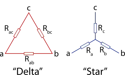

Additional comments for those who think electric field can reshape in a conductor along the conductor:
These are simply delta and star connected networks. Now if electric field could reshape then the lines of forces will intersect at three points for the delta and one point for the star networks. But we all know that lines of forces can not intersect. Hence no reshaping of field lines take place.
