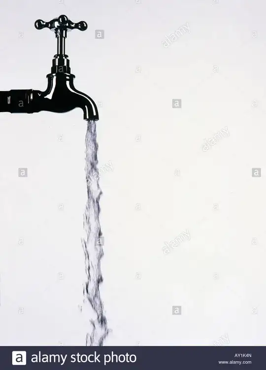

I noticed today that if I took a glass of water and poured it out slowly (small tilt to the cup), it flowed rather smoothly, but when I increased the tilt the water flowed in a sort of helical manner, this could be observed in the given image in the case of a tap:
What could the possible reason for such a flow be?
Considering Plateau-Rayleigh instability (mentioned in comment), could it be that if speed of water flow be quick enough that the flow doesn't break down to form drops. This is what my limited non mathematical understanding brought me to.

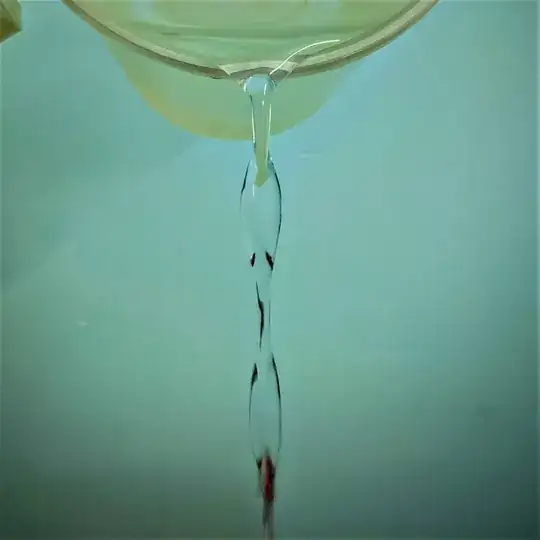

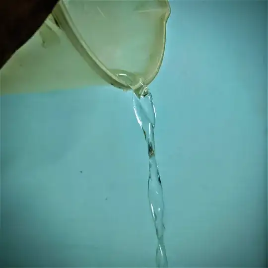

I did the experiment and observed the pattern too. But I'd say that the pattern was not really helical, it was more like the shape of a metal chain. Here you can see the same image from two different angles.
Front view
Front
Side view
side view

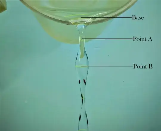

When you look carefully at the two images, you would see the flowing water is flattening out in mutually perpendicular directions as it falls down the cup. This works due to a principle similar to the one behind shape oscillations of a freely suspended water droplet. Only difference is that here, you don't have an oscillation in the direction of the flow. So this is actually a 2D case of water drop shape oscillation.

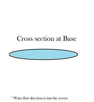

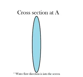

At the point where water loses contact with the cup (which I shall call 'Base'), the film is stretched out horizontally due to the normal reaction of the cup. When the film leaves the base, surface tension would provide a restoring force for the film. The film would get fully stretched in the perpendicular direction at position A.
base
A
This sets up a 2-D oscillation. The film would oscillate between these two states as it falls down.

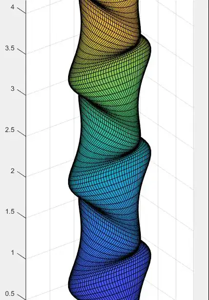

When you plot the different time states of the above depicted 2-D oscillation in along a Z-axis, you get a pattern similar to the one we observe in reality (but less curvy).
gif1
Here we have not included any damping forces between adjacent cross-sectional films. If we had, we would have obtained a much smoother shape.
