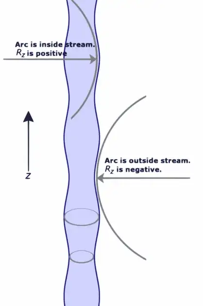

The shape of the spout of your milk jug makes the milk from the edges flow towards the center - but as this means that the profile is trying to get narrower, the milk "has to go somewhere" and makes the jet wider in the other direction. However, surface tension is pulling back on the liquid (it would prefer the jet to be a perfect circle) so the liquid starts to be forced back. This can in principle happen a couple of times before instability tears the liquid apart.
This is a form of Rayleigh Instability - see for example this diagram:
from the corresponding wikipedia page
