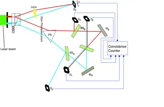

The experimental setup is this: Delayed Choice Quantum Eraser
A photon is sent through a double-slit where it passes randomly and then is split into two entangled photons. The upper entangled photon (signal photon) hits the D0 detector where its x position is recorded. The second photon (idler photon) goes down to the lower part of the diagram where it either is reflected into D3/D4 by BS (which gives us information about its path) or it passes through to another reflector (unlabeled in the diagram) that destroys its path information.

Whenever a photon is detected by D4 or D3 we should get a "clumping pattern", rather than an "interference pattern" (that's the terminology used in the video, I don't know if it's correct) because we know about the photon's path. If it hit D4 then we know it came from the lower slit (blue line) and if it hit D3 it came from the upper slit (red line).
The Grand Reveal, amazingly, is that the result from D0 will also show that clumping pattern! Somehow, even though D0 happens before D4 or D3 it "knew" that its entangled twin was going to be detected before it even happened.

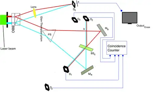

To demonstrate this, here is the same experiment with only the eraser (I removed BSa and BSb and labelled the final reflector BSc):
Eraser Mode
Quantum Eraser (Only Eraser)
Let's call this Eraser Mode since all it does is erase our knowledge.
In the top-right corner, I have connected the output of the D0 detector to a monitor where we will plot the x impacts.
If the video and (my reading of) the commentary are correct, then since I do not have information about the path that the photon took, I should see an interference pattern on the ${Output}_{Erase}$ display.
This, I'm guessing, is not true and is another hole in my understanding. Rather, the Coincidence Counter must be what enables the creation of the interference pattern, but the article seemed to indicate that the detector itself shows that pattern.

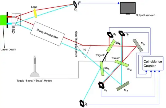

The problem is that if there is a different pattern on ${Output}_{Signal}$ than there is on ${Output}_{Erase}$ then I could use that to predict the future.
Quantum Predictor
I could set up a delay mechanism between the Glenn-Thompson prism and the BBO so that it takes a long time for the photon to make it to the prism. Let's say I send it through 120,960,000,000 km of fiber optic cable (a cable so long that it could go around the equator >3 million times) so that it takes a week for the photon to make it from the BBO to the prism (assuming the speed of light in the cable is 200,000 km/s). In the meantime, I can measure the pattern on the D0 detector.
If I have switched the lever to the Signal State, then BSc is removed and it will only show the non-interference pattern. If instead, I switch it to the Erase State then the BSa and BSb are removed and it will show me the interference pattern.
If I see that the output is an interference pattern I can conclude the system will be in the Erase State when the photon arrives in a week. If I see a clumping pattern I can conclude the system will be in the Signal State when it arrives in a week.
Of course, then I can get up to all sorts of shenanigans by, say, writing a script that flips the switch if Bitcoin ever goes over 10k in that week (or whatever).
This future prediction trick makes me pretty sure that my understanding is incomplete. In particular, I think the gap is in understanding how the coincidence counter uses the incoming data to create the interference pattern.

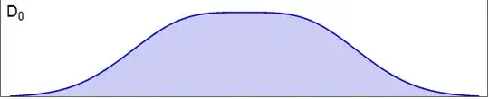

It does not matter what you do to the idler photons, the output of D0 in both cases (Signal Mode and Eraser Mode) will be this:

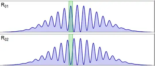

In the case you turn on Eraser Mode and you check the photons of D0 that hit R01 = D1 or R02 = D2 you will get this:
Take a look of how R01 and R02 are dislocated from one another. If you add both signals together, you get R01 + R02 = D0. Notice how the peaks of R01 align with the troughs of R02, such that the final result is the value in D0. This mode results in an interference pattern only because you can sort between the photons of each sensor.

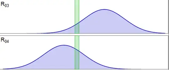

If you now switch to the Signal Mode, such that R03 = D1 + D4 and R04 = D2 + D3, this is what you will get:
In the same way as before, if you add R03 and R04 you will get D0, but in a different way from the Signal mode. And by "different way", I mean that now there is no interference pattern. You see no interference pattern since the phothons are concentrated around one location (one peak for each slit/sensor).
As you can see, looking at D0 will not help you get any future predictions, since it will always yield the same result, no matter what you do to the entangled photon. The patterns only emerge after the coincidence counter sorts which photon went to each sensor.
