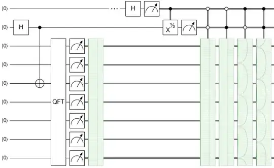

For example, here is the example delayed choice eraser circuit from my quantum circuit simulator Quirk:
delayed choice circuit
The green boxes are state displays that show the probability of each possible measurement result, optionally conditioned on some other qubits' possible measurement results.
The top wire is the "choice" qubit. The second wire is the "which slit" qubit. The rest of the wires are the "where did it hit on the screen" qureg. The first two operations setup some entanglement between the which-slit qubit and the screen qureg.
The four displays on the right show that, if you group the screen measurements by the choice qubit and the which-slit qubit, then within the groupings you will see an interference pattern if and only if the choice qubit is ON.

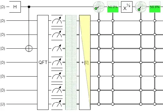

But correlation goes both ways. Instead of thinking about how the choice qubit and which-slit qubits predict the screen measurement, we can think about how the screen measurement predicts the which-slit qubit's state.
It would be tedious to set up $2^7$ bloch sphere displays, each conditioned on a different screen measurement. Instead, let's use a single condition but cycle through offsets to the screen measurement. This circuit makes it very clear that the landing position on the screen is correlated with different states of the which-slit qubit:
screen landing predicts state of which-slit qubit
This diagram also answers your main question:
[given a landing position] is the signal photon more likely to be detected at D1 [than D2]?
Yes. The value analogous to the D1-vs-D2-given-position likelihood is shown in that green box in the top right of the diagram. The chance is changing as we focus on different positions.
Notice that the qubit is spinning like crazy regardless of whether we applied the $X^{1/2}$ rotation that will be controlled by the choice qubit. All the $X^{1/2}$ rotation does is switch which axis the qubit is spinning around as I vary the screen measurement position being focused on. If there is no $X^{1/2}$ rotation, the spinning goes around the measurement axis, and so doesn't affect the probability of measuring ON-vs-OFF (i.e. we've picked a rather poor measurement axis). But if the $X^{1/2}$ is applied, then the spinning is around the Y axis instead of the Z axis, and so does translate into changes in computational-basis measurement probability.
