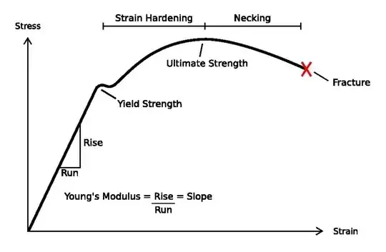

Whenever a force is applied on an object a strain is caused. This strain is given by $\Delta \ell / \ell$ for longitudinal strain. Now the restoring force is proportional to the amount of strain produced (within the elastic limit of the material). This restoring force is generated because all materials are made up of atoms and when they are pushed together then they resist this by applying a force which originates from the EM force between the atoms. This restoring force is measured via stress ($F/A$, $A$ for area of cross section).
Stress-Strain curve
When the elastic limit is reached (here indicated by the yield strength) the proportionality relation ends and the material starts showing plastic behavior and in this region even a small increment in stress causes a large amount of strain.
Now in case of ground when elastic limit is reached the ground starts deforming much faster and applies a much smaller reaction force as compared to the case if it was in its elastic limit. Now in the graph you can see that for each material there is a point of ultimate strength after which a strain is produced even for smaller stress and then the material reaches it's fracture point where it applies no reaction force at all.
So you can see that when the weight on the ground causes stress larger than ultimate strength then the ground starts collapsing and nothing else can be done to stop the object from sinking any further.
