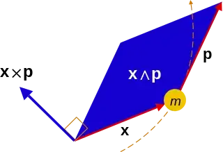

This is one of those times where simplifications can get in the way.
In more formal contexts, angular momentum is not actually a vector. It's something called a bi-vector. It is the bivector constructed by taking the exerior product of the vector from the axis of rotation to the object and its momentum, $L=x\land p$, rather than their cross product $x\times p$.
However, there's a catch. Exterior products take a while to learn, and the reasons why you would want to use the are rather nuanced. And, very conveniently, in 3 dimensions, for every bivector $x\land p$ there is a corresponding pseudovector $x \times p$ called an "axial vector" for which the equations are identical. You'll do the same operations to manipulate the numbers because the same $|x||p|sin\theta$ term will show up in both sets of math. (this stops being a universal thing that can be done as we go into higher dimensions)
So we teach momentum as a cross product. The price of this is that the meaning of the direction of that vector is kind of murky, as you noticed. It's a whole lot easier to teach, but we lost a little intuition along the way.
Representation of bivector
If you look at the way one thinks of a bivector and how we visualize them, the momentum bivector is all within the plane of rotation. You have the exterior product between the displacement between the axis of rotation (clearly in plane) and the momentum of the object (clearly in plane). One thinks entirely in the plane of rotation. The only reason the out of plane vectors ever appeared was because we used the cross product to create an axial vector to represent the deeper bi-vector. If you avoid that extra step, then we never see anything out of plane.
So we teach angular momentum using axial vectors, because it makes it easier to teach. We don't need to teach new operators. However, at a deeper conceptual level, they are more correctly bivectors, and that should help explain why that non-intuitive out-of-plane angular momentum feels out of place... because it is. It's not wrong, just a little troublesome for intuition.
