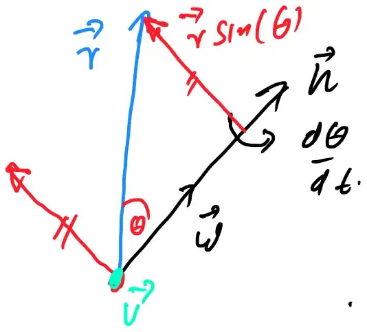

I want to show that $~\vec v=\vec \omega\times \vec r$
The components of the a vector $~\vec r~$ that given in body fixed coordinate system (index B)
can be transferred to inertial system (index I). with this equation:
$$\vec{r}_I=\mathbf R\,\vec r_B$$
where $~\mathbf R~$ is the transformation matrix between body system and inertial system
take the time derivative ($~\vec r_B=~$ constant) $$ \frac{d}{dt}\left(\vec{r}_I\right)=\mathbf{\dot{R}}\,\vec r_B$$
with $$\mathbf{\dot{R}}= \left[ \begin {array}{ccc} 0&-\omega_{{z}}&\omega_{{y}} \\ \omega_{{z}}&0&-\omega_{{x}}\\ -\omega_{{y}}&\omega_{{x}}&0\end {array} \right] \,\mathbf R$$
you obtain $$ \vec v_I=\frac{d}{dt}\left(\vec{r}_I\right)=\left[ \begin {array}{ccc} 0&-\omega_{{z}}&\omega_{{y}} \\ \omega_{{z}}&0&-\omega_{{x}}\\ -\omega_{{y}}&\omega_{{x}}&0\end {array} \right] \,\mathbf R\,\vec r_B=\left[ \begin {array}{ccc} 0&-\omega_{{z}}&\omega_{{y}} \\ \omega_{{z}}&0&-\omega_{{x}}\\ -\omega_{{y}}&\omega_{{x}}&0\end {array} \right] \,\vec r_I=\vec \omega_I\times \vec r_I$$
so $$\boxed{\vec v=\vec \omega\times \vec r}$$
enter image description here with
$$\vec \omega=\frac{d\theta}{dt}\vec n\quad ,\parallel\vec n\parallel=1\\ \vec r=r\,\vec e_r\quad \parallel\vec e_r\parallel=1$$
thus $$\vec v=\vec\omega\times \vec r=\vec\omega\times \vec r_\perp= \frac{d\theta}{dt}\vec n\times (\vec e_r\,r \,\sin(\theta))=r\sin(\theta)\frac{d\theta}{dt}\vec e_v$$
where $~\vec e_v=\vec n\times \vec e_r~$
$$\Rightarrow\\v=r\,\sin(\theta)\,\dot\theta$$
