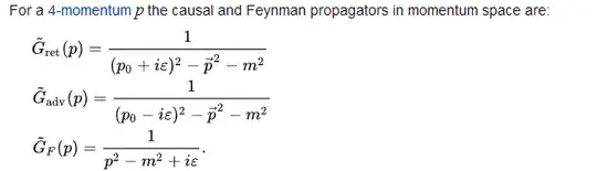

As you have stated, virtual means mathematical tool. The four vector of a virtual particle changes according to the kinematics of the incoming and outgoing particles, mass can even be negative. What makes the difference at our time in the cosmos is that symmetry breaking has given a physical mass to free Z and W. This mass enters in the propagator representing the virtual particle in the Feynman diagram .
In both position space and momentum space propagators , the mass of the virtual particle enters in the denominator. When the virtual exchange has a small mass the total probability contributed to the interaction can be large, photon, electron (not to forget there are a lot of virtual particles in feynman diagrams).
propag
The variables are under the integral of the Feynman diagram. This is to show that the real mass of the virtual particle exchanged in the diagram enters in the denominator, thus when large, diminishing the probability of the interaction the Feynman diagram represents.
With the enormous mass of the Z and W the diagram is suppressed, which is what makes the weak interaction , low probability of the final integral calculation. Before symmetry breaking, all forces were equal in this sense as the masses are zero.
How do we experimentally prove that virtual W and Z bozons have rest mass?
Virtual are not experimentally measurable except by the calculation of the total probability for the experiment fitting the data, i.e. indirectly. The model of feynman diagrams for the calculations has been validated by all experiments up to now, and if we find a violation, we look for extensions of the standard model and not for a change in mathematics.
