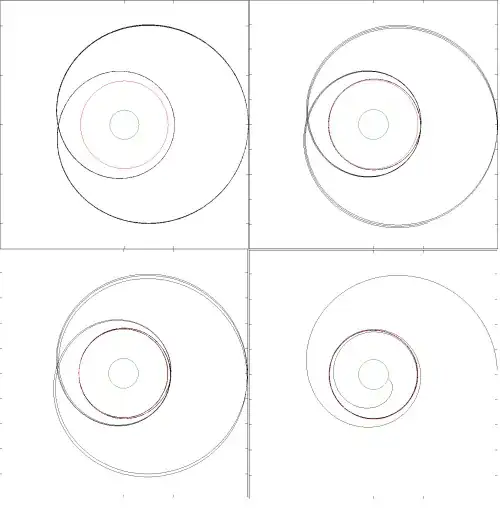

The approximation you mentioned is the post-Newtonian expansion at the first, 1PN level. As you can see it introduces two velocity-dependent components and one repulsive inverse r-cube component. If you try to apply it in the strong field limit you get very strange results, as seen in this answer. The post-Newtonian expansion is available also at the 3PN-level. At the 3-PN level more velocity-dependent terms are introduced as well as a attractive inverse $r^4$ term and one repulsive inverse $r^5$ term. I have not checked out those orbits yet. However, at the 1PN level you can not really reproduce the expected strong field orbits. If you use this (not officially sanctioned) expression for the relativistic acceleration instead:
$\frac{d\bar{v}}{dt}=-\frac{GM}{r^2}\left(\hat{r}-3\frac{v^2(\hat{r}\cdot\hat{v})\hat{v}}{c^2(1-\frac{2GM}{rc^2})} +\frac{v^4(\hat{r}\cdot\hat{v})\hat{v}}{c^4(1-\frac{2GM}{rc^2})^2}\right)$.
you can reproduce orbits as seen below. The green circle is the Schwarzschild radius and the red circle is at the "innermost stable circular radius" located at a radial distance of three Schwarzschild radiuses. If you look closely you can see that in the upper left plot the planet completes two revolutions between consecutive aphelions. In the upper right it completes three revolutions between aphelions and in the lower left it completes four. The mimimum radial distance I got with the lower left simulation was at a little bit more then 2.98 Schwarzschild radiuses. If you want to reproduce the results you can start with Mercury at aphelion and then scale up the relativistic effects by increasing the initial velocity with a certain factor and decrease the initial radial distance with the same factor squared. In the plots I used factors of 1668, 1682.167, 1682,452 and 1682.45768. Depending on step size etc. you might get to use slightly different values to get the same symmetry.
