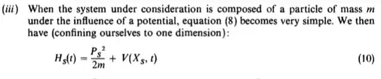

In the book Quantum Mechanics by Cohen-Tannoudji, at $G_{III}$, it is given that

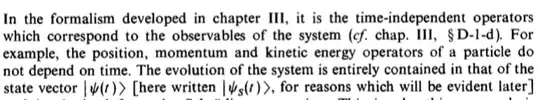

and then in the comment section, it is also given that
so I'm pretty confused in here, because in one side, they say they assume that the observables are time-independent observable. On the other hand, they given an example where an observable, namely the hamiltonian, is a function of time.
So my question is, are observables, in general, assumed to be time-independent operators in QM ? If so, why ? Is there an argument for such an assumption ?
