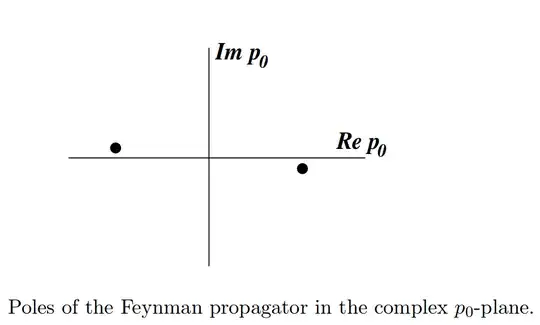

Now here I've been told that the fact of replacing $T\rightarrow (1-i\varepsilon)T$ to define the path integral is equivalent in Fourier space as $p⁰ \rightarrow (1+i\varepsilon)p⁰$. With this, one gets the correct $i \varepsilon$ Feynman prescription for the propagator $D_F(x-y)$
\begin{equation} Z[J]=Z[0] \text{exp} \left(-\frac{i}{2} \int \frac{d⁴ p}{(2\pi)⁴} \hat{J}(p) \frac{1}{p²-m²+i\varepsilon} \hat{J}(-p) \right) = Z[0] \text{exp} \left(-\frac{1}{2} \int d⁴y \int d⁴x \ J(x) D_F(x-y) J(y) \right). \tag{6} \end{equation}
And this is the part that I don't get at all, I've tried but I don't see how the fact that $T\rightarrow (1-i\varepsilon)T$ leads in the previous approach to $p⁰ \rightarrow (1+i\varepsilon)p⁰$ and therefore to the Feynman prescription. I'm having nightmares with this, any help would be really appreciated.
