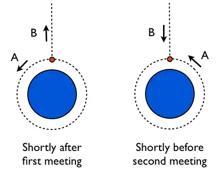

Many questions on Physics SE relate to the twin paradox, but I did not find any that ask this specific question. Suppose that object A is in a circular orbit around a spherically symmetric, non-rotating planet (Schwarzschild metric). Suppose that object B is in radial free-fall, with a worldline that meets object A on the way up (passing arbitrarily closely without colliding) and again on the way down, as depicted here:
Object A executes exactly one period of its orbit between the two meetings, and both objects remain in free-fall between the two meetings.
The question: Which object ages less between the two meetings?
