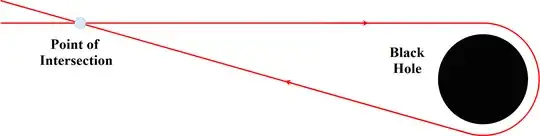

  2. Space is globally Schwarzschild, but twin A is situated very far away from the central black hole where space is, to good approximation, flat. Twin B immediately turns off their thrusters and coasts along their geodesic with no noticable acceleration in their frame. The Geodesic happens to take them close to the black hole, completely curving around the black hole and turning back on itself, back towards twin A (eventually passing by them again).
A suggestion of a geodesic around a Schwarzschild black hole which turns back on itself. Figure 1: a suggestion of a geodesic around a Schwarzschild black hole which turns back on itself (not to scale).

I believe your (fairly complex) question is answered in a general way on Kevin Brown's Mathpages, in this article: https://www.mathpages.com/rr/s6-05/6-05.htm
It compares the elapsed times for two different inertial motions in the Schwartzschild spacetime that intersect at beginning and end. Applying to your specific question is an exercise for the reader!

Are situation (1) and (2) equivalent when viewed from twin A's frame?
No. The equivalence principle says that the outcome of any local experiment is the same if you are at rest in a gravitational field or accelerating uniformly. Situation 1 and 2 are therefore not equivalent.
First, the experiment is not a local one per the meaning used in the equivalence principle. In the equivalence principle “local” means that it is conducted over a small enough region of spacetime that tidal gravity is negligible. In other words, the gravitational field should be uniform and the spacetime should be flat to within the precision of all measurement devices. In this scenario the gravitational field changes substantially during the slingshot. So it violates the locality condition of the equivalence principle.
Second, since the equivalence principle requires that all experimental outcomes are the same. This includes measuring the readings on accelerometers. As you said:
Twin B feels a force of acceleration in case (1) but doesn't feel anything in case (2).
Which means that an accelerometer reading will be non-zero in case (1) and will be zero in case (2). This is an experimental difference which shows the non-equivalence. Personally, I find thinking about accelerometers to be very useful in figuring out what should be equivalent to what in the equivalence principle.
Suppose that we modify case 2 as follows: the twins are in a small laboratory (small enough that there are no tidal effects) where the whole laboratory is near the gravitating body and is kept stationary with respect to standard Schwarzschild coordinates by means of thrusters. Twin B sits in a chair in the lab while twin A jumps. The twins synchronize their clocks at the moment that A jumps off the floor and compare them when A lands.
Case (1) would be modified as follows. In Case (1) we will locate the lab in flat spacetime far from any gravitating source, but we will use the same lab and the same twins and the same chair etc. In particular, the thrusters will be firing at the exact same rate as before and A will jump with the exact same force as before.
All experimental results will be the same in the modified cases. Twin B will measure the same non-zero accelerometer reading in both cases and twin A’s accelerometer will read 0 during the jump. Also, the clocks carried by A and B will read the same. Since we can easily calculate the clocks in A’s frame in case (1) we can use those results to exactly predict the clocks in case (2)
