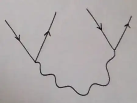

Normally, a process that violates energy conservation (of the free Hamiltonian!) by an amount $\Delta E$ can only survive for a time $\hbar/\Delta E$. Energy is only strictly conserved (in scattering for instance) for processes where the initial and final states are at $t=\pm \infty$. For example, you could create the state with two positrons and two electrons through the process (time going up):
but it would only last a time $\hbar/4m_e \sim 10^{-22}$ seconds. The reason in that in the interaction picture for scattering from $t=-T$ to $t=+T$, the scattering probability will look something like
$$P \sim \left|\int_{-T}^T\!dt\,e^{i(E_f-E_i)t}\,\langle f | V|i\rangle\right|^2\sim \frac{\sin^2(E_f-E_i)T}{(E_f-E_i)^2}\left|\langle f | V|i\rangle\right|^2$$
You can check that this is non-zero for times $T\lesssim 1/(E_f-E_i)$.
However, when gravity is included, time can be stretched, making short-lived states very long-lived. This happens when you have a horizon, like when there is a black hole or in an accelerating frame, in which case time can be infinitely stretched, producing matter. I think this also happens in inflation but there the particles get pulled away from each other. Not sure how to show this in terms of quantum mechanics.
