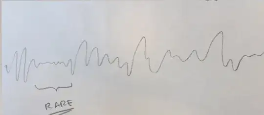

Take a potential landscape with a pure, random, uncorrelated disorder:
Because of the purely random nature of the disorder, it is quite rare to have a region in which the size of the flucuations is quite small.
So rare regione = region with small to no disorder.

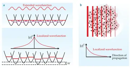

In condensed matter, a disordered potential may induce the single-particle phenomenon of Anderson localisation. This is an insulating state, but unlike the band insulator it is in a non-crystalline solid, and unlike the Mott insulator it is not a many-body/strong correlations effect. Intuitively, it is understood as the wavefunction reflecting from all the random facets of the potential landscape. If and when these reflections are of the same mangitude of the original one, it leads to destructive interference and hence spatial localisation (image): enter image description here

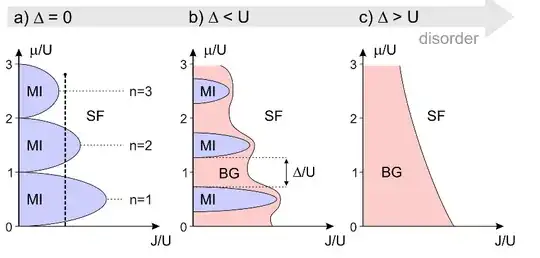

The Bose glass comes up in the phase diagram of bosons in the tight-binding model (Bose-Hubbard):

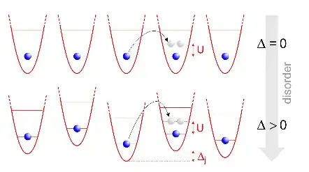

where these pictures are from the Fallani paper above, $U$ is the on-site energy, $J$ the next-neighbour tunnelling ("how much atoms can move around, transport") and $\Delta$ the disorder strength:
It was known that, in the absence of disorder, bosons undergo a transition from a superfluid (off diagonal long range order, phase coherence, gapless excitations) to a Mott insulator (no phase coherence, gapped excitations). This is controlled by $J/U$, i.e. superfluid when $J\gg U$ such that particles can minimise their energy by delocolasing and being long-range ordered, and an insulator when $U\gg J$ such that repulsive interactions pins the atoms on each site individually.
Adding disorder $\Delta$, introduces another phase of matter -- the Bose glass.
This is not phase coherent (like the Mott) but has gapless excitations (like the superfliud), hence it's a mixture of both. I can expand on this bit mathematically if you wish.

This about being very close to the glass-superfluid transition, but from the Bose glass side. As the disorder is reduced, there are some rare regions where the disorder strength is quite small (see first picture) and which allows the wavefunction to establish "long" range order. At the transtion, these regions grow in size (percolation) and become the superfluid.
