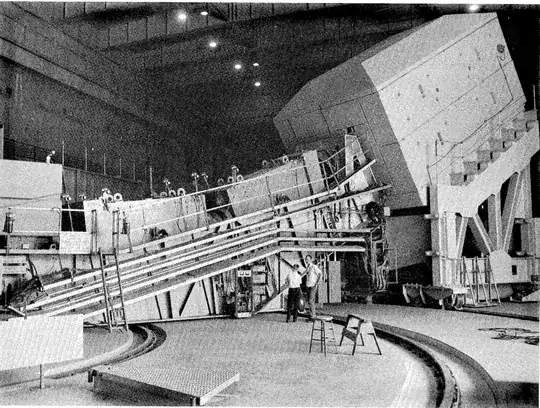

This was initially done at SLAC, with an electron beam, a liquid hydrogen target, and 3 spectrometers, not whimsically named the 1.6 GeV, the 8 GeV, and the 20 GeV spectrometers.The 8 GeV Spectrometer in End Station A
The spectrometers allowed precise detection of the scattered electron's (lab-frame, duh) momentum and scattering angle.
