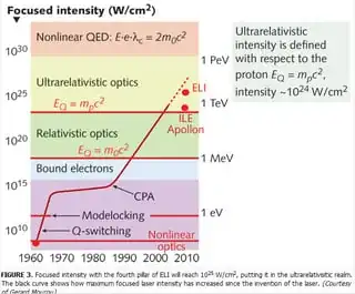

To emphasize the importance of this, if you look at the largest available peak laser intensity over the past few decades, there's a very, very flat line lasting some fifteen years between the late sixties and 1985: this is the threshold where self-focusing makes it impossible to amplify the light further without the laser destroying itself, a problem which was only solved with the advent of chirped pulse amplification.
For a more recent take on that topic, see What is Chirped Pulse Amplification, and why is it important enough to warrant a Nobel Prize?
