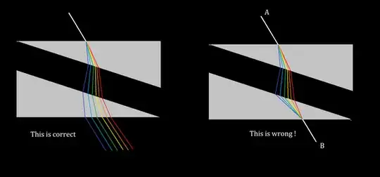

I know that refraction is due to different speeds of different wavelengths of light. So, How can those colors recombine to form a beam of white light (since different colors have different speeds)?
Is this image telling me the real fact?
The answer to your question is a little more subtle. In your picture, there is nothing but two prisms that are identical, and so the text is correct, this will not recombine the same white light that was originally separated into separate wavelengths.
Though, it is possible to recombine the white light in your case, but not with this setup. You cannot recombine the white light with just the identical prisms in your picture. You need a different way.
However, this recombination is impossible if only two identical prisms are used,9–11 as can easily be checked by applying Snell’s law to rays that enter and exit the faces of the two prisms, since the rays corresponding to each color emerge parallel to each other. It is possible to perceive the recombination of white light that has been initially decomposed by a prism by using more elaborate optical setups than the one (see Fig. 1) criticized in this note, including setups based on the use of a converging lens,4,14 mirrors,4,15 or more than two prisms.10,11
https://aapt.scitation.org/doi/full/10.1119/1.5018680
There are several ways to recombine, in one you need three laser pointers, and two prisms where the height is a little bit larger then the distance between the upper and lower stacked pointers.
In another setup that can recombine white light, you need a lens of focal length f at a distance of 2f from the first prisms.
The lens is required to bring the rays back together. It creates an image of the exit of prism one on the entrance of prism two. The figure below shows how Newton did it. White light enters at O, it is split and recombined by the second prism. The third prism splits the light again. This experiment demonstrated that white light is made from lots of separate wavelengths.
