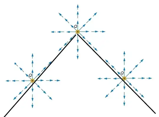

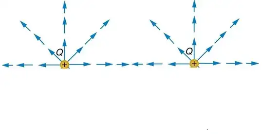

it is simple to understand it is actually because- the filed of charge feel more stable (less electrostatic repulsion force charge at sharp age then at plane so high no of charge are easily come across sharp end and increase intensity near sharp end.enter image description here
see shape factor (approx hemisphere part facing large most of repulsion.enter image description here charge feel less repulsion then a plane on sharp point . as shown.

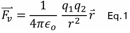

If we have two charges Q1 and Q2 separated by a distance r in a vacuum. the force between them is given by equation #1.
Where ϵ_o is the permittivity of vacuum.

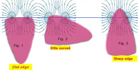

If we put the two charges on the surface of a metallic conductor which has an irregular shape the force between the two charges depends on whether the surface is flat or curved.
Assume we put the two charges at the same distance on fig1, fig2, and fig 3.
If the surface is flat as we see in fig. 1 the conductor shield almost half the electric field lines which means the force between the two charges approximately equals half its value in a vacuum.
In fig.2 the surface gets a little curved and shields more electric field lines than in fig. 1, which means the force between the two charges is less than in the case of fig. 1.
In fig.3 the surface of the conductor gets sharper and shields more electric field lines than in fig2 and fig1, and the force between the two charges decreases more than in the Case of fig.2.
The charges leave the flat edges which have the higher repulsive force and accumulated at sharp edges where the force between them is minimum.
In conclusion as much the surface gets curved the electric field lines get shielded more and more, which means the force between the two charges at sharp edges is less than the flat edge.
So, if we charge a metallic conductor that has an irregular Shape the charges density will be large on sharp edges than on flat ones. We should also mention that a large charge density at sharp edges means a large electric field.
