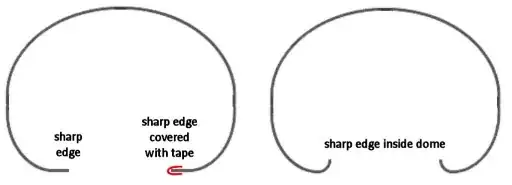

The shape of the dome is important particularly as it must have no sharp edges or points.
This means that if you were to use a cylindrical shape you would need to round the edge.
The reason for this is that as the radius of curvature of a conductor decrease the charge density in that area increase which in turn increases the electric field in that region.
If the electric field is too high the air breaks down and becomes a conductor resulting in charge being lost from the dome thus reducing the maximum potential of the dome.
The left hand diagram is of a dome with a sharp edges (left) with the sharpness of the edge reduced by placing "insulating" tape over the sharp edge (right).
A better solution is to fold the sharp edge inside the dome.
Dust on the dome will act as points and dents will have edges which will reduce the effectiveness of a dome to store charge at high voltages.
