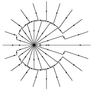

In fact, this follows almost automatically from the finite propagation speed of light. The electric field of a stationary charge obeys Coulomb's law. If the charge suddenly starts moving, the field won't obey Coulomb's law anymore, but it can't instantly change everywhere because of the finite propagation speed. Instead a "shockwave" of information goes out from the charge at speed $c$. This shockwave contains electromagnetic energy and travels at the speed of light -- it is light.
