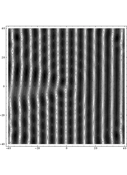

The original Bohm-Aharonov proplem [Y. Aharonov and D. Bohm Phys. Rev. 115, 485 (1959)] is about electrons scattering from a solenoid. They give a nice solution to the Schrodinger equation as a sum of Besssel functions that it is fun to plot: Bohm with 1.4 unit of flux through solenoid
The image is the real part of the wave function for the case of 1/4 unit of flux through the solenoid. Wave incoming from right. The B-A phase shift results in the downstream above and below wavecrests being offset by 1/4 of a wavelength. The wavefunction itself is everywhere single-valued though.
